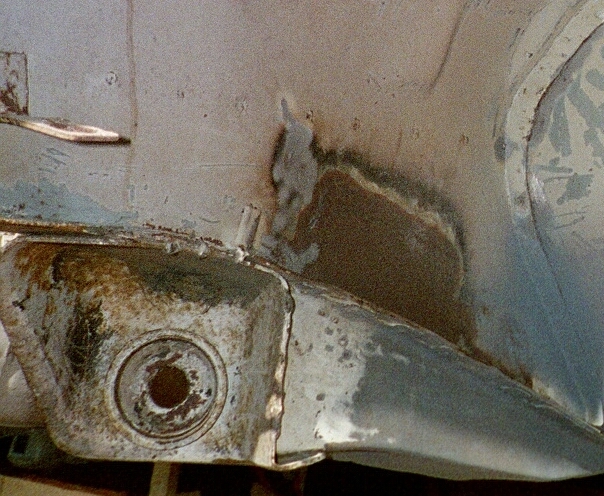

I'm guessing you are referring to the radius rod mount.
You will either have to have a new one folded up and welded in or hack one off a wreck.
If you can post a pic. of the damaged one, perhaps we can advise the best course of action, repair or replace:ermm:
Is this the bit causing you grief?
[This is actually the passanger side of a RHD '73 240Z]
Nissanman. That was very helpfull. Thanks for the correction on the radius rod mount and the great photo. You hit the nail on the head. Unfortunately, the answer was the one I feared most. Looks like we need to fab something or, as you say, find a hulk. The passenger side is mostly rusted out and I believe beyond repair. The driver's side is just fine. Guess I need to get to work. Any other thoughts out there? Any parts cars available in Florida? Thank you for the quick and accurate reply.
