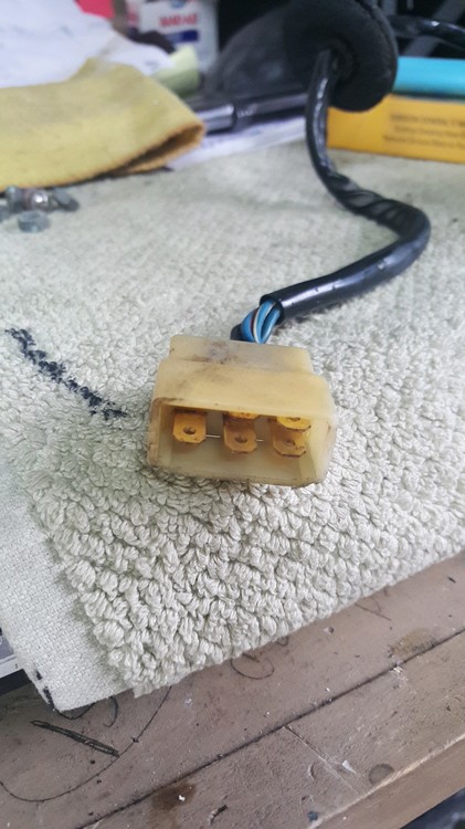

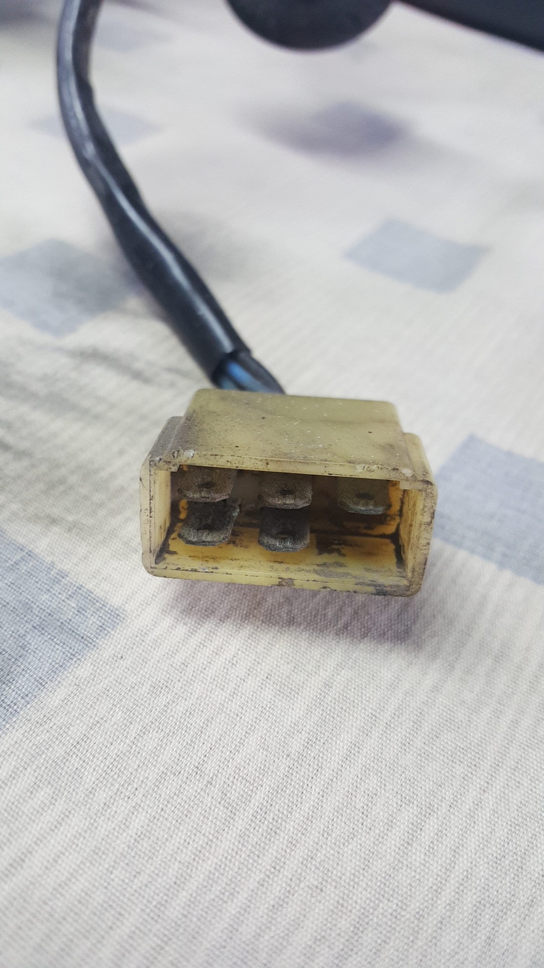

Great article. Thought I would try to fix my original. turns out it was the copper commentator the brushes ride on was corroded. Also the plug...after sitting 32 years in a barn. Found this quick fix on the filthy plug. CLR soak. 20 min. Here is a before and after.
If you can't get to a bone yard or pick a part...I found an awesome fix for slow early z wipper motors. First I cleaned inside the motor. Commentator and brushes. New grease where needed. And then bi-passed the LR power lead to motor with direct 12v from battery with 30/40 relay and 30a fuse. Works amazing...even on dry window.

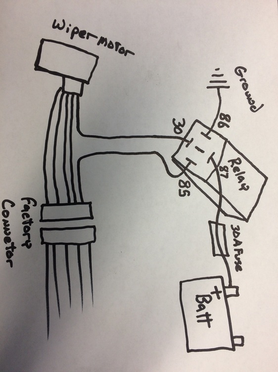

On 6/6/2013 at 6:53 PM, tamo3 said:
Rain season is over here in CA, but I'm about to have wiper motor upgrade for my '75 280z.
Following '75, '77, and '78 FSM and this thread, I drew diagram for wiring.
Did this set up work. And what did you do with the unused blue/white and yellow wires from the oem harness?  ( sorry that I'm 9 years late to the conversation  :). )
