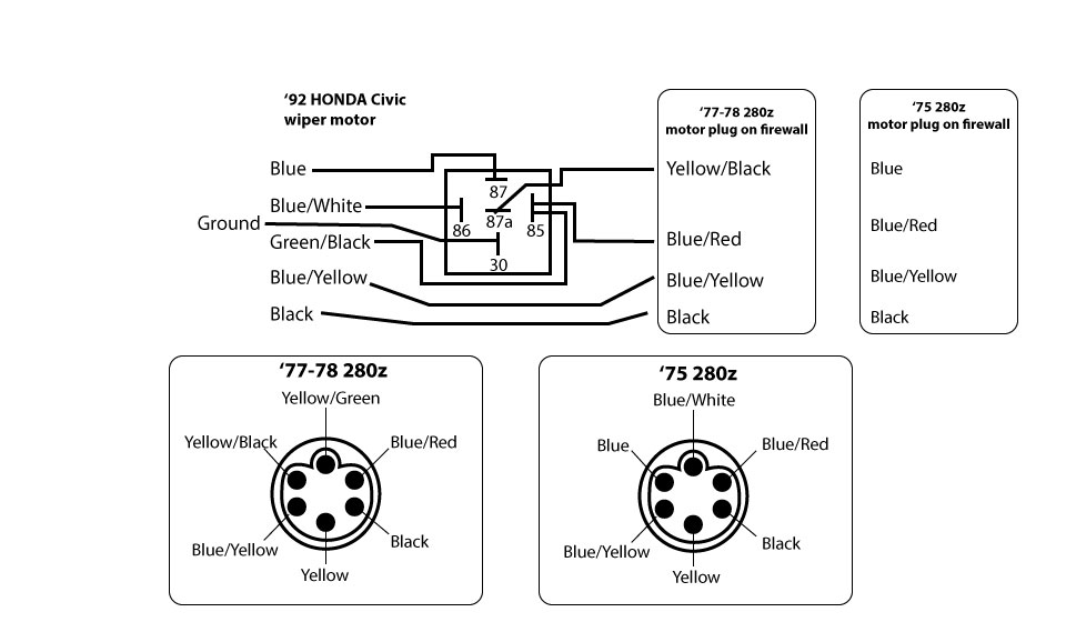

Rain season is over here in CA, but I'm about to have wiper motor upgrade for my '75 280z.
Following '75, '77, and '78 FSM and this thread, I drew diagram for wiring.

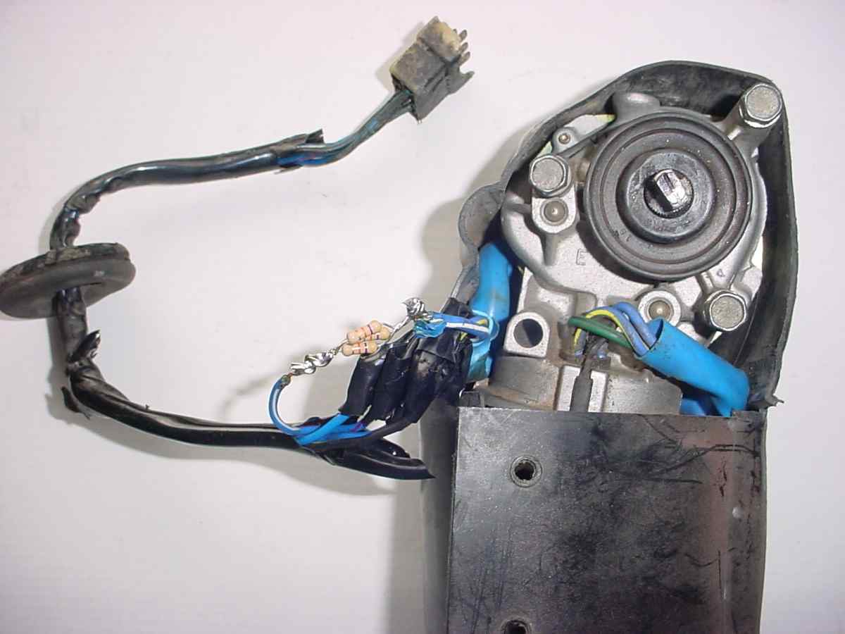

You did your post here last January, I also installed a 97 accord wiper motor. The park switch is a rotating switch inside the case on top of the plastic gear (a copper brush and a piece of metal mounted on the gear). The motor turns the gear and switch which makes sure the wipers park at the bottom of the windshield by connecting the park switch across the same place the low speed wires connect. The park switch is open when the wipers are at the bottom of the windshield and closed otherwise. When the intermittent turns on briefly and then off the park switch keeps the motor going until the wipers park. That is why your wiper keeps stopping in various places on the windshield, the intermittent turns the motor on briefly expecting the park switch to continue providing power to park the wipers but the park switch never takes over. The original wiper motor in my car (1970) used a relay for the park function. The relay makes sure the park switch lasts a long time. The wipers on my car with the 97 accord motor do not park but once I connect the park switch it will make intermittent operation (with an intermittent gizmo from an auto parts store) and park possible, something I will add when everything else is done. This is all assuming that when the 97 accord motor was installed I ground the shaft flat sides at the correct angle as the park switch rotation position for park cannot be changed.
Trying to compensate for the switch turning off at the wrong time with an electronic time delay is chancy as that approach assumes the speed of the motor is constant on each wipe but I personally feel the approach might have merit from the standpoint that the wipers would park in approximately the same position each swipe which might be less annoying than the wipers stopping at random points. Anticipating further work on this I connected a 14.7K resistor in series with the wire on the wiper motor that I think is the park switch (blue/white wire-gives an open circuit to ground on park) as I wasn't sure what the other end of this wire connected to and didn't want to blow a fuse. From inside the car a time delay circuit could be rigged to this wire (or a relay with the other end of the coil at 12V) which would connect to the slow wiper wire making a pseudo park workable, I hope. I hope this lengthy diatribe helps a teeny bit.
Mike
