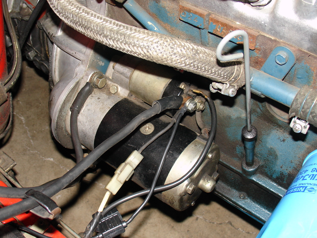

I have am finishing up an engine swap. Everything is in and connected and I am just about ready to fire up the motor. HOWEVER. I have completely forgotten where the battery cables go! And for whatever reason, it is not obvious to me. Wiring diagrams are not helping because basically I need a picture.
Positive cable from the battery goes to the starter right? Where does it attach to the starter?
Negative cable has a big bolt going through it. Ground to the bell housing?
Sorry for this really lame question and thanks for any help. :stupid:

Positive battery cable to the starter. There is a large 8mm bolt sticking out of the solenoid on top of it with nothing attached. That's the one. There are two similiar such terminals but one has a un-insulated copper wire going inside the starter. That's not the right one.
The negative goes to one of the bolts that holds the starter to the bellhousing. If it already has two, take out the top one and see if the bolt dangling in your negative cable is the same size. Use the one that fits that best (length wise). Find out where the other bolt goes! Do you have four 10mm bolts in the bellhousing that go in from the trans side not counting the two that hold the starter? Are the two 8mm bolts at the bottom going through the rear cover and bell housing? Go over everything before you try starting.
Make sure BOTH NEG and POS cable ends and hardware (all 4) are shiny clean!! Got a ground from the battery to the firewall?
And of couse make sure the neg/pos on are on the right battery terminal!!
