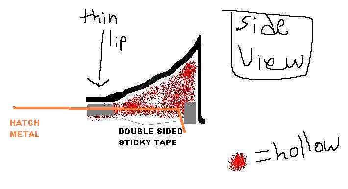

When mounted on the hatch, does that rearmost edge butt up to the rear downward edge of the hatch?
If so, you might be able to mount it with double stick tape, the automotive type. See my edit of your picture.

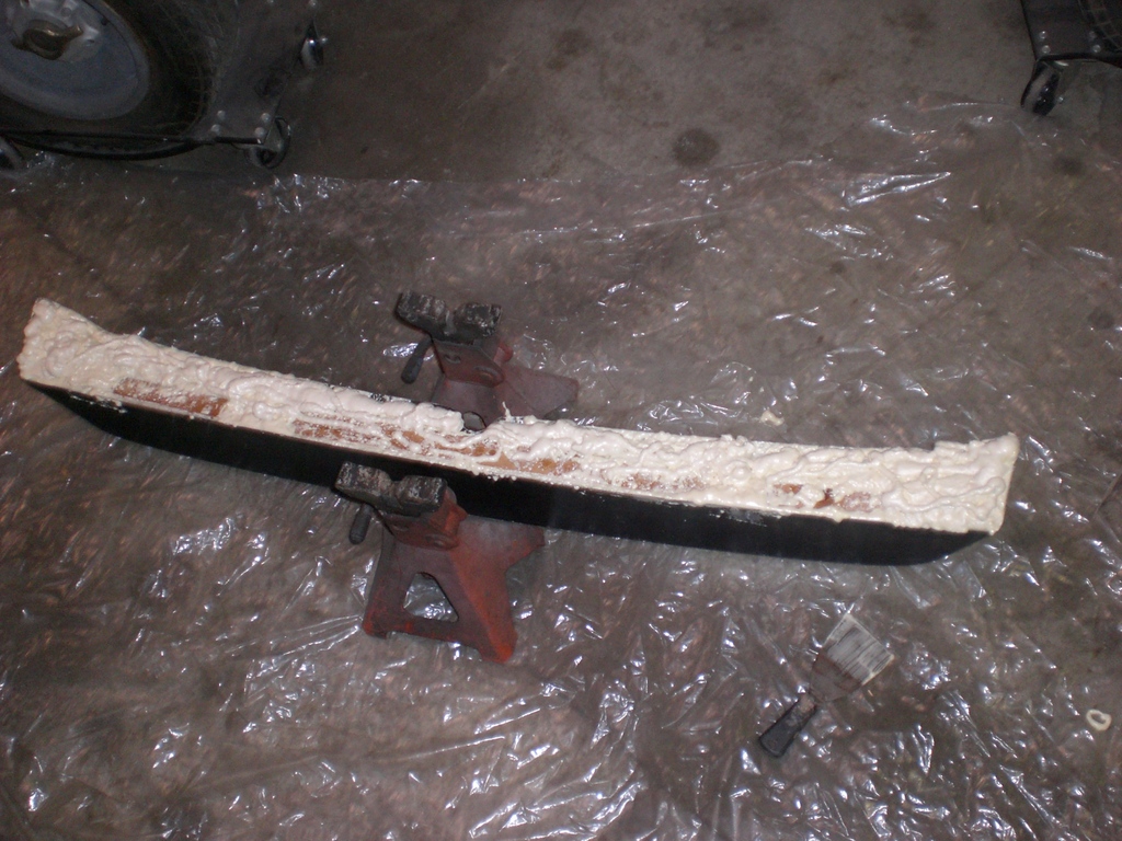

I haven't made a spoiler one yet because the foam we sprayed is still drying. We did in fact get the foam you use on outside outlets, its called Great Stuff, $6 at Home Depot. We cut some would to squish into the foam. What we plan on doing is getting threaded inserts, drill and thread a hole in the wood, put the inserts in, and then put bolts through the hatch and into the inserts rather than using wood screws. Now there won't be any pressure on the fiberglass, just the wood held in by the foam. I plan to glass on the spoiler to so it looks clean but you have to be careful because the resin will melt foam and you don't want all your foam inside to melt. :]
Here are some pictures:
http://img174.imageshack.us/img174/9098/cimg0072ne8.jpg
http://img214.imageshack.us/img214/6231/cimg0080wx2.jpg
http://img214.imageshack.us/img214/8733/cimg0081wo0.jpg
The last one is my dad in one of his toys... We finally got around to clearing out the cockpit and removing the steering wheel. Before neither of us could fit because of our knees. It was the first time we had a grown person sit in it (baby step brother has sat in it). Long story short, he got all excited. :P
Regarding that rear fin spoiler. Mine is also hollow, I just used a "slicon like" product called SIKAFLEX and a pplied it as per your first pic with the red line to show glue. Not sure if you get it in the US back it's worked fine for some years now. Oh and I brace the front bar as per the pics above also worked good.
