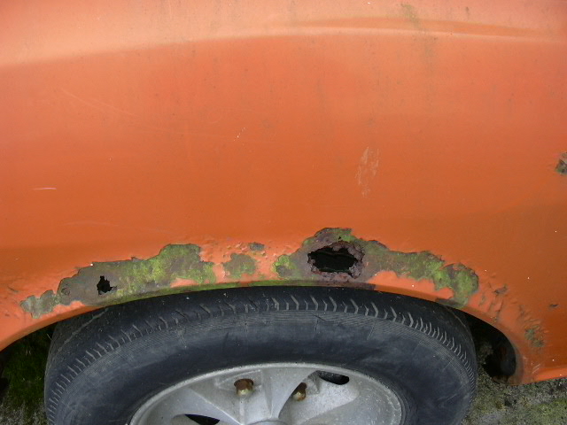

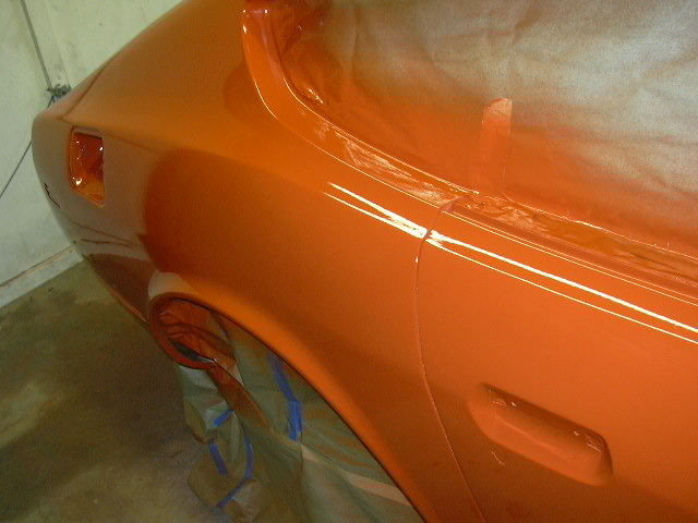

I bought the patch panel for the right quarter from MSA. It had the tabco sticker on it but, it was not in stock at Tabco. I found the 240 panel to fit better then I expected. I cut the old metal out and all the critical points lined up nicely. Crimped the old fender and screwed the new metal in place adjusted it twice and then welded it up. Looks like before and after:
