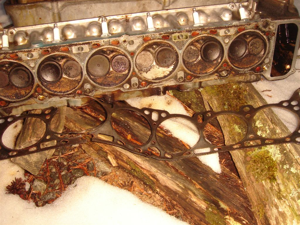

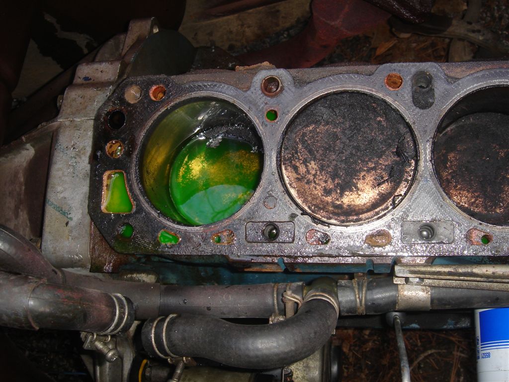

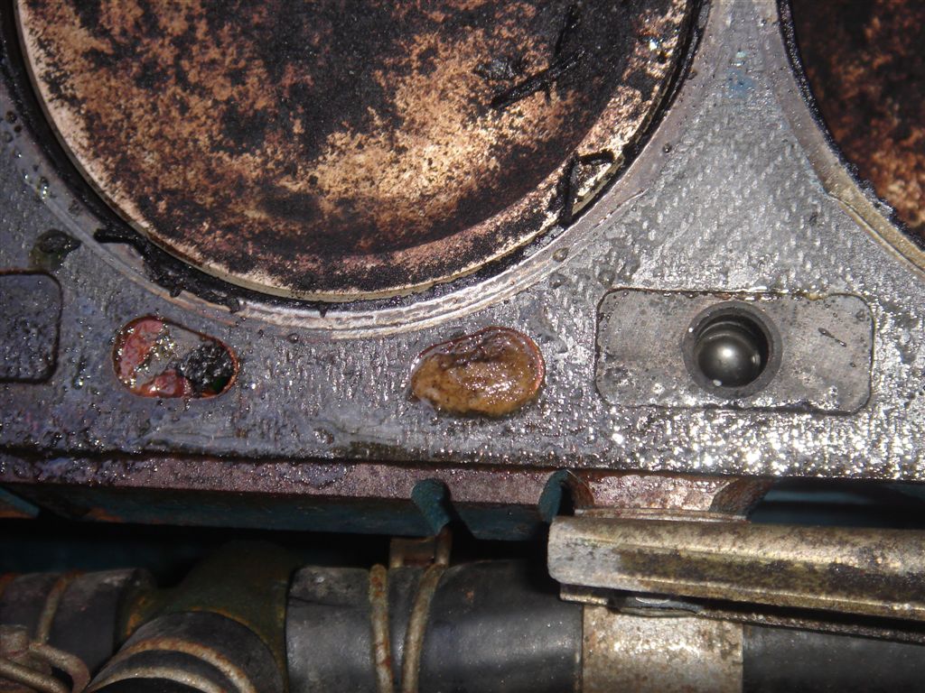

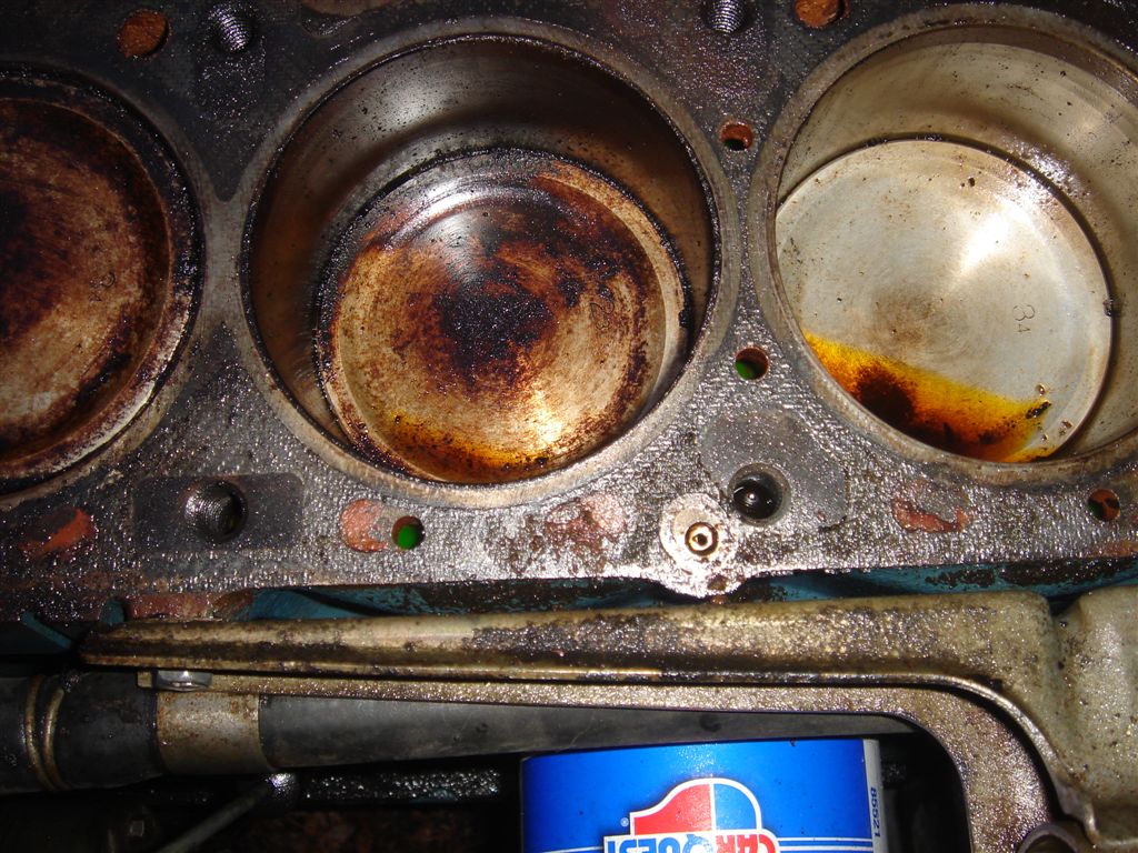

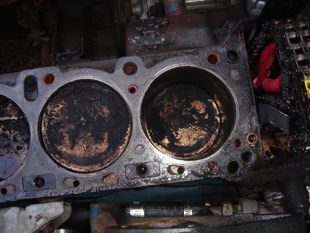

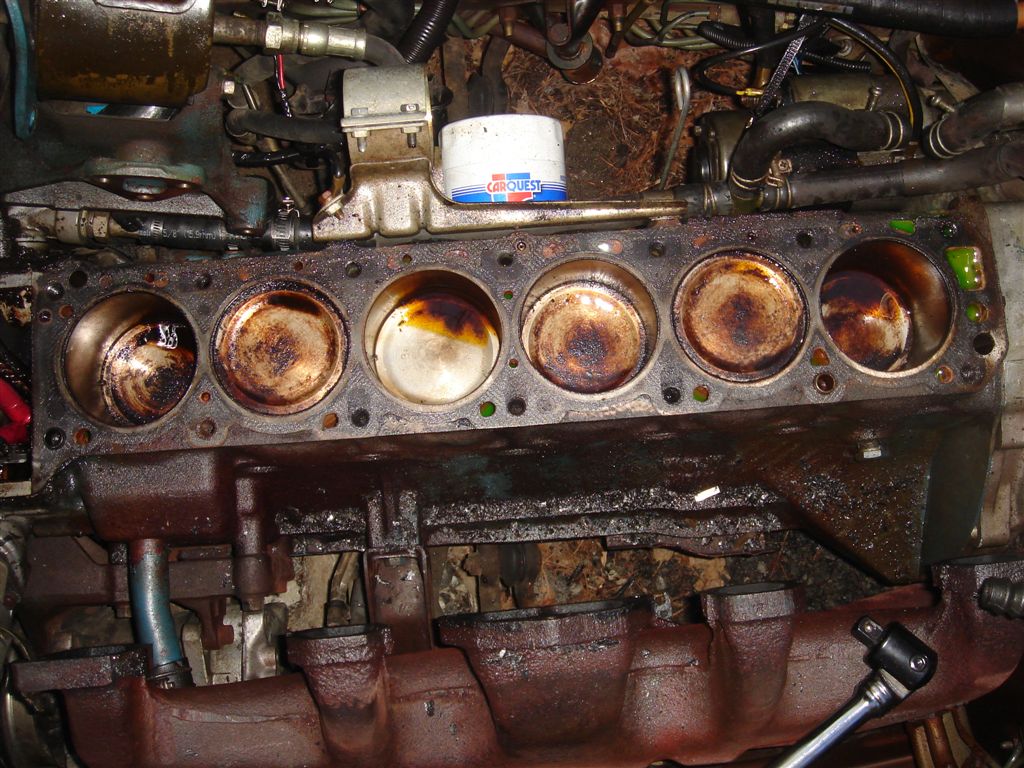

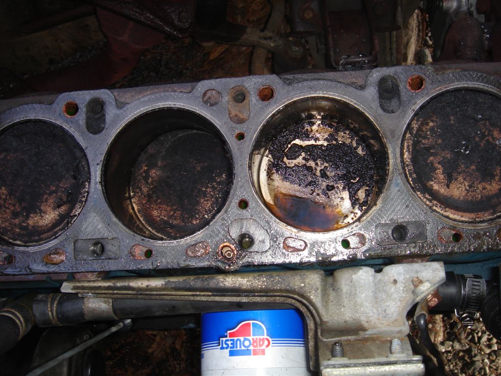

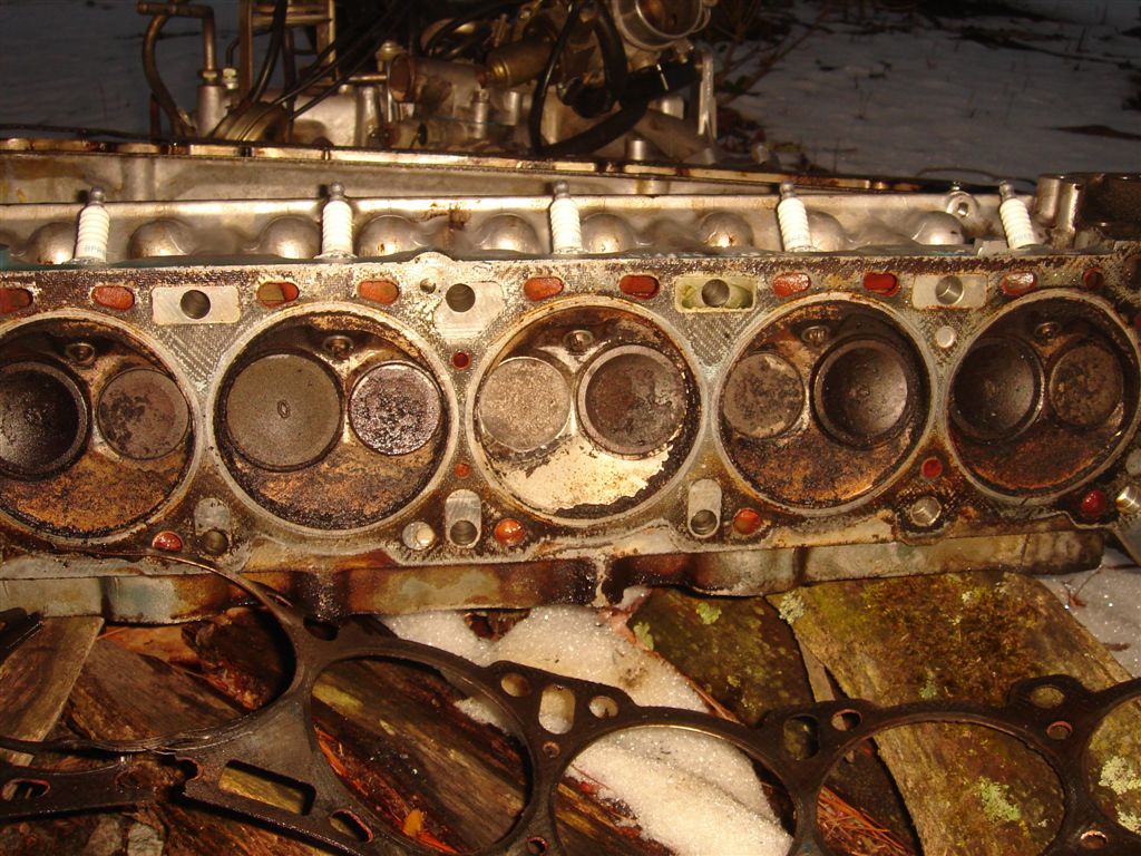

January 19, 200817 yr Author comment_234653 Here are the photos of the block. Link to comment https://www.classiczcars.com/forums/topic/26808-head-gasket-mis-adventures-part-1/#findComment-234653 Share on other sites More sharing options...

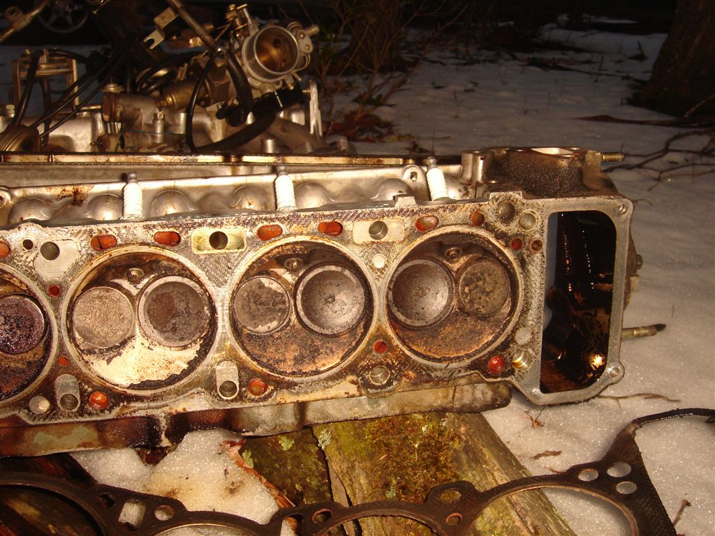

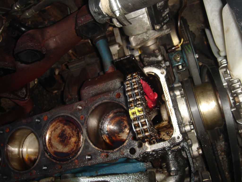

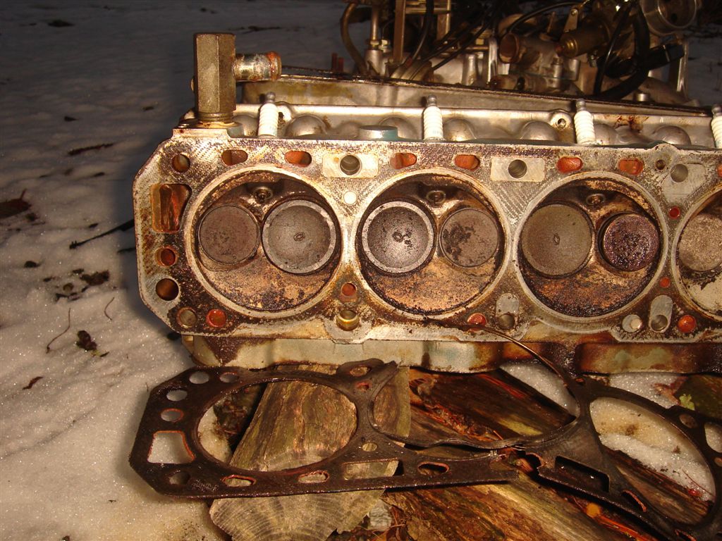

January 19, 200817 yr Author comment_234655 And of the head and gasket (kind of). My apologies for being so long winded (worded?), and thanks for making it this far. Any and all thoughts on this are appreciated, so long as your advice isn't "get a garage." (unless I can borrow yours). My thanks go out to Will and AJ (by extension) for helping with this mess! Link to comment https://www.classiczcars.com/forums/topic/26808-head-gasket-mis-adventures-part-1/#findComment-234655 Share on other sites More sharing options...

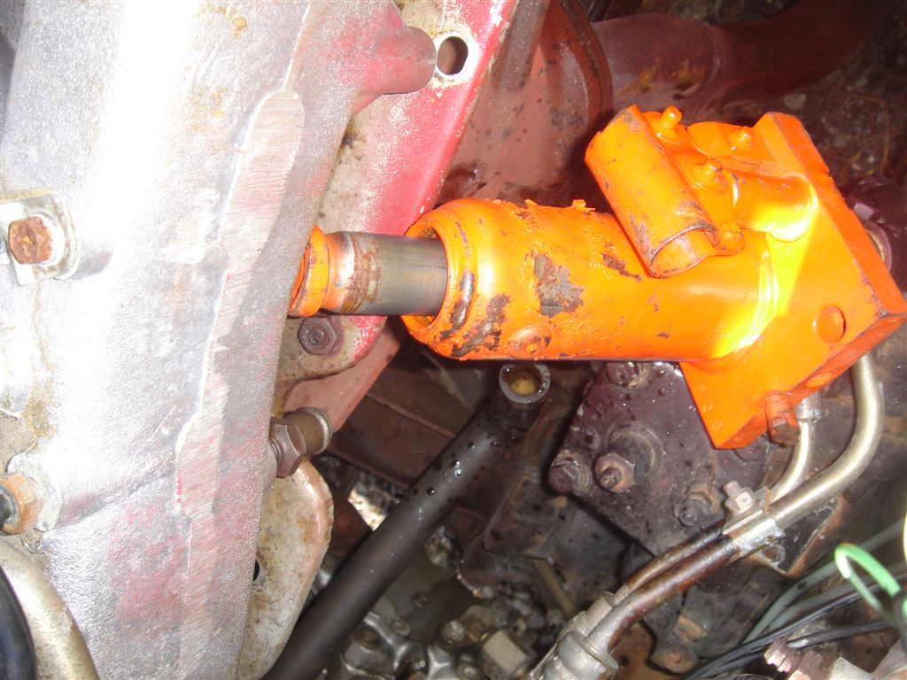

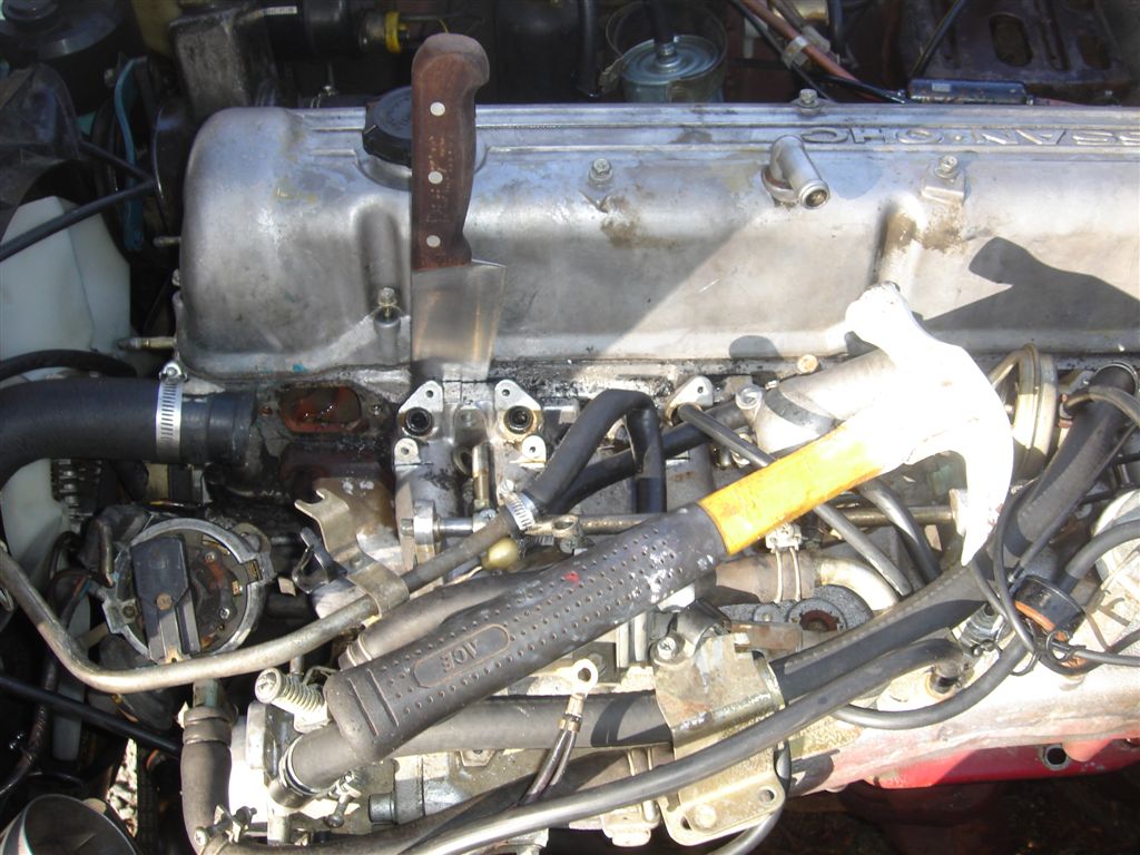

January 19, 200817 yr comment_234661 Ok, you may or may not appreciate my responses but here they are: 1. Garage yes you need one, so do I, joys of living on a fixed income!! 2. That butcher knife stuck between the manifold and head is a CLASSIC! (True "surgery" on the ole z car) 3. If you ever need help, I will try my best to assist, I know I am up the road a little ways, but maybe I can give you moral support at least Last but not least, thank you VERY much for the details and the pictures, they will be a huge help when I do the head on my '81 280zx although I will be doing mine after I yank the engine. Link to comment https://www.classiczcars.com/forums/topic/26808-head-gasket-mis-adventures-part-1/#findComment-234661 Share on other sites More sharing options...
January 19, 200817 yr comment_234666 Your head may be slightyly warped, which is why you had coolant in #3. I experienced the same thing on my car - HG was fine, head showed no cracking, but the head was warped 0.02". Make sure you have the head checked out by a competant shop.The fire ring on #3 does not look round but rather sliiiiiightly oval. This is indicative of a loss of clamping force/pressure which could be a result of a warped head. Link to comment https://www.classiczcars.com/forums/topic/26808-head-gasket-mis-adventures-part-1/#findComment-234666 Share on other sites More sharing options...

January 19, 200817 yr comment_234730 It does not have to be a Z shop, just a good "head" shop. Call around to your local hot rod stores/shops and see if they recommend any body. If you get 2 or 3 shops recommending the same place, you are golden.You are not asking them to rebuild the head, simply check for straightness and, if you want, a pressure test. Link to comment https://www.classiczcars.com/forums/topic/26808-head-gasket-mis-adventures-part-1/#findComment-234730 Share on other sites More sharing options...
March 13, 200817 yr comment_240501 Agreed. You have done so much work up to this point, it would be a shame not to get the head checked for straightness. Its relatively painless and inexpensive. But to not do it, may mean that all your work is in vain. Link to comment https://www.classiczcars.com/forums/topic/26808-head-gasket-mis-adventures-part-1/#findComment-240501 Share on other sites More sharing options...
March 13, 200817 yr comment_240524 When you re-attach the head, you WILL be using new hardware, right?Ideally, use head studs, especially if you don't find someone to check your head for straightness. You can torque the head down tighter with the studs than you can with head bolts. They're only a bit more expensive than head bolts.Summit sells a kit for $135.http://store.summitracing.com/partdetail.asp?part=ARP%2D202%2D4206&autoview=skuI had suspect compression in neighouring cylinders on a 5 cylinder Audi motor of mine. On the Audi, like the Datsun, the head bolts are stretch bolts. In theory, single use. So, with the head still attached, out came the old bolts, and in went the head studs, which can safely be torqued down more tightly.I took another compression test, and I had regained the lost compression. In my case it was a band-aid temporary solution til the head comes off. In your situation, it could straighten out a _slightly_ warped head, and, if you can find a competent machine shop to check your head, you will have done it completely right, with the best chances for long life! Link to comment https://www.classiczcars.com/forums/topic/26808-head-gasket-mis-adventures-part-1/#findComment-240524 Share on other sites More sharing options...
March 14, 200817 yr comment_240551 It's probably not warped but... An engine machine shop will check flatness for free if you're nice. It takes a minute with a proper straightedge and feeler blades. While you're there ask them about the mating face. If it needs milling then the valves, cam towers etc willl have to come off. It will be cheaper for you to do the disassembly/reassembly. Just keep all parts labeled to the right # port. (Dixie cups are good) The price my shop used to charge for disassembly was around $150. Here's a link which might help you in understanding how to help your head gasket seal. http://www.enginebuildermag.com/Article/2434/gaskets_sealing_todayx2019s_engines.aspx More than likely it's just some corrosion in the aluminum. (Mating face of head)Probably some pitting near the water passage letting things get by. It could also be internal corrosion which has eaten through to one of the ports. (Zyglo or good visual inspection would detect this) If it is corrosion in the face of the head a new head gasket may not/probably won't cure it. (not for very long anyway ) The face of the head will need to be milled in this case. It's interesting when you start reading about heads and the surface finishes required on the mating surfaces. Today's standards of finish are greater than those in the past and modern car's head gaskets are designed for said finishes. As the head heats up it expands more than the iron block does so things slide. This is why it's good to have flat/smooth mating surfaces. "Smooth" is reffering to the "ra" or microfinish imparted during machining. Using sandpaper or other abrasives will damage the flatness. 2c Jim Link to comment https://www.classiczcars.com/forums/topic/26808-head-gasket-mis-adventures-part-1/#findComment-240551 Share on other sites More sharing options...
