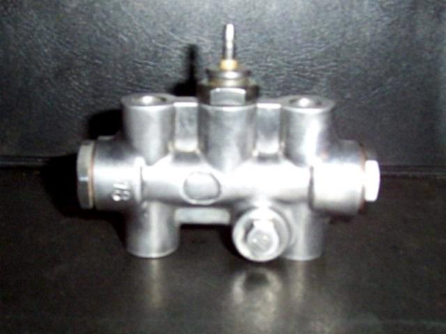

February 2, 200817 yr comment_236137 sblake:Yes my master was replaced by the previous owner, and it does have 2 wires that are attached to it, but they are just wrapped up and are not attached to anything. My mechanic could not find anything that they should attach to, this has puzzled me all along. In theory they should go somewhere, but they don't. There is a wire that is attached to the brake warning switch, but I cannot tell from where it originates. I was looking through my stuff this morning and I found this. Don't know where I picked it up. I have amassed quite a few Datsun parts over the years. Don't know if it's good. Can't hook it up and test it since my 78 doesn't use it but if yours turns out to be bad you can give it a try. Link to comment https://www.classiczcars.com/forums/topic/26859-brake-light-wont-go-off/?&page=3#findComment-236137 Share on other sites More sharing options...

February 2, 200817 yr comment_236161 We established that on the first page of this thread. 78 and up had the wired m/c caps, 77 and down had the switch I pictured in my previous post. He addressed the relay, also on page one. I was just letting him know I have the switch if he ends up needing it. Link to comment https://www.classiczcars.com/forums/topic/26859-brake-light-wont-go-off/?&page=3#findComment-236161 Share on other sites More sharing options...
