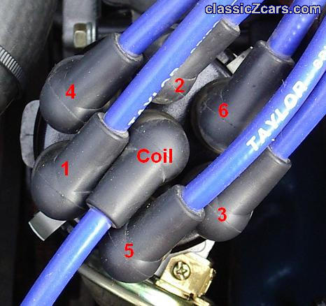

January 24, 200817 yr comment_235282 Matches said: Ok, so I will check again with the valve cover off to see what points where. With the valve cover on, I was fairly certain that I did have TCD on #1 with the rotor pointing where it should, but the timing mark on the crank pulley was way advanced. I know I have fuel because it comes out the fuel return line if I disconnect it, and spark because I took out the plugs and tested each one by grounding it and cranking the motor. Thanks for the help guys I know you were fairly certain, but the pics you have supplied prove the TDC determination you made to be incorrect. Pic #1 is of the standard positioning of spark plug wires on the distributor of a 240Z. #1 is where I stated earlier, just clockwise to the front distributor cap retaining clip. Yours, as I mentioned earlier, is pointing to #3. Based on your first pic (edited below), the #1 exhaust valve is open, and intake is closed. That is very much not TDC. Disregard your crank pulley's indicator until you have TDC determined by direct observation as I outlined in my first post. It is not uncommon for the pulley's indicators to shift as the rubber between its components wears. In re: fuel....you have fuel at the return line, and that is well and good. You didn't mention what the state of your carbs is...if they are old, the float needle and seat/grose jet/whatever my be stuck closed, and fuel will bypass the float bowl and stay in the supply/return system. If they are new and there's fuel in the float bowl then you can disregard fuel issues for now. Link to comment https://www.classiczcars.com/forums/topic/26868-trying-to-get-her-started/#findComment-235282 Share on other sites More sharing options...
February 16, 200817 yr Author comment_237418 OK updates at long last. After following the advice of xray and Arnie, it seemed as though the rotor was way off mark. So I dropped the oil pump and fussed with things until I got it right. Here are photos of my results: See the rotor pointing to the #1 spark plug wire, and the crank pulley timing mark @ the zero point. When like this, the cam shaft looks like this: 10 o'clock and 2 o'clock right? So everything is properly aligned for TCD right? Spark plug wires go just like the photo xray posted. STILL WON'T START! Is it time for me to buy a compression tester or am I still missing something? New cap and rotor, ignition coil is only a few months old, new spark plugs and wires, carbs are rebuilt from Z Therapy and where running great on my old engine exactly as the are set now. I know there is fuel because there is fuel on the spark plugs after cranking. I know there is spark because I grounded out each plug and cranked and looked for spark. Got it. Looks weak, but I figure its an old car and that is probably what it looks like. Thanks so much for all the help so far. This is really frustrating. -Matt Link to comment https://www.classiczcars.com/forums/topic/26868-trying-to-get-her-started/#findComment-237418 Share on other sites More sharing options...
