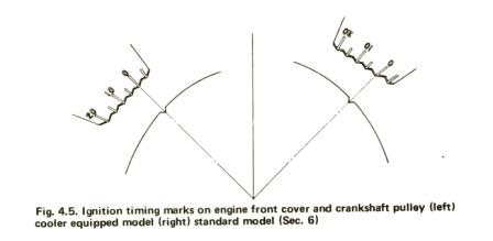

February 17, 200817 yr comment_237444 This is what I am referring to: Link to comment https://www.classiczcars.com/forums/topic/26868-trying-to-get-her-started/?&page=2#findComment-237444 Share on other sites More sharing options...
February 17, 200817 yr comment_237454 KTM, My L-24 had the indicator on the driver side, My F-54 block on the passenger side. I have seen it both ways . I now have a pulley that is going to go on the F-54 and this will change it to the driver side along with the pointer. I am changing because it is a light dampener. Like was gone over several times here. Find out if the engine and head has been separated and or if the cam was removed or changed. Link to comment https://www.classiczcars.com/forums/topic/26868-trying-to-get-her-started/?&page=2#findComment-237454 Share on other sites More sharing options...
February 17, 200817 yr comment_237458 Usually, the variation in sides is a result of whether or not the engine was fitted with AC. Of course in the repair shop, a non-AC crank pulley may have been fitted to an engine with AC front cover timing marks, or vice versa. Nothing mechanically wrong with that BUT, it puts the timing reference marks WAY out of whack:rolleyes: Link to comment https://www.classiczcars.com/forums/topic/26868-trying-to-get-her-started/?&page=2#findComment-237458 Share on other sites More sharing options...
February 17, 200817 yr comment_237487 Nissanman, you are absolutely right if this is the case. Funny thing though both of my engines were AC equipped at some point. I think you are right in that the pointer may just need to be repositioned on the other side. Gary Link to comment https://www.classiczcars.com/forums/topic/26868-trying-to-get-her-started/?&page=2#findComment-237487 Share on other sites More sharing options...

February 17, 200817 yr Author comment_237531 Nissanman said: There is a similar discussion on this problem which you might find helpful, http://classiczcars.com/forums/showthread.php?t=27188As previously mentioned, you may need to work backwards to determine where the TDC pointer and crank pulley notch need to be.It is the KEYWAY on the crank that will tell you piston TDC.How do I find this keyway? I can't see anything on the crank pulley that is obvious to me Link to comment https://www.classiczcars.com/forums/topic/26868-trying-to-get-her-started/?&page=2#findComment-237531 Share on other sites More sharing options...
