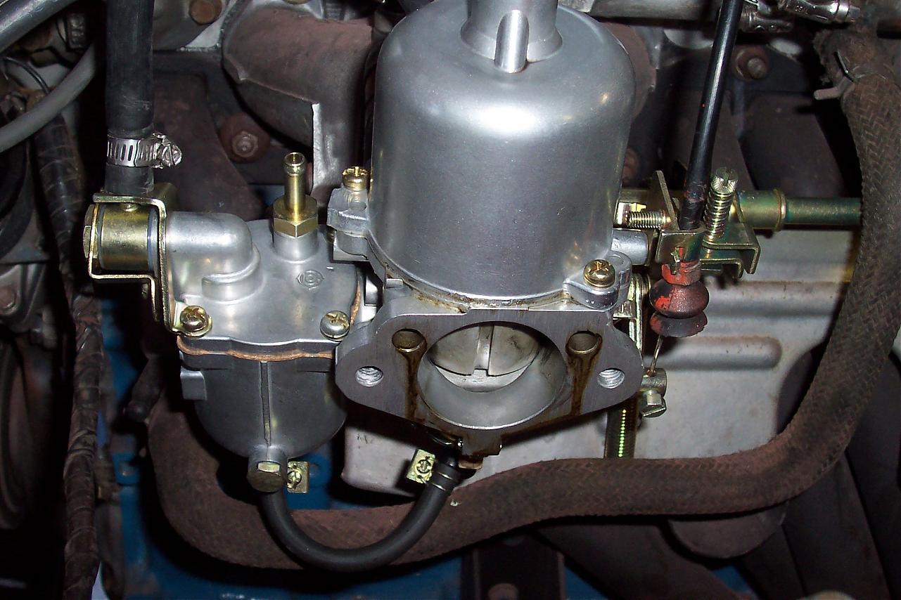

My symptoms are very similar, but I'm using 2 brand new ZTherapy SU round tops, so I'm certain that the carbs aren't the problem. Getting good fuel, getting what I think is good spark. I didn't do a compression test, but the car only has 26K on it, the head was magnufluxed, so theres no cracks. The car ran before tear down, so I have no reason to think theres a compression issue.
The car backfires, will barely run once every few tries, and its expelling unburnt gas back out through the new carbs. When it does run, there no throttle there, and if I give it any gas, it'll stall.

The carbs are set at 2-1/2 from ZTherapy. I haven't messed with the carbs, took them out of the box, bolted them on.

Still just misfiring, and "spitting" out of the intakes. I haven't richened the mix yet, I figured with them set at the baseline 2-1/2 from ZTherapy, they should at least run. If I do play with the mix, how much (or little) should I adjust each try?

My mix nuts were not preset at 2 1/2 turns. My refurbed ZT carbs required some work to function well (adjust choke, adjust float level, adjust mix nuts), so they may not all be "plug and play." You should probably double check yours.

I guess maybe I should adjust the float level up a little bit. I double-checked it after shipping, and it was right around where it should be (9/16") from cover. But I adjusted the mixing nut out to about 4 - 5 turns from (2 - 3 more than how it was shipped), with almost no change. Since the float level is the gross adjust, I think I need to bend the tab, and bring up my float level. Sound like the next best guess?
Other than the "backfiring" through the carbs, the only other thing I can see is this fuel puking back through the carbs after I try starting.
