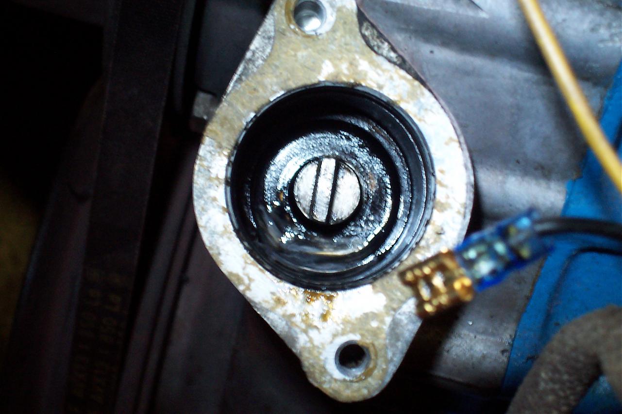

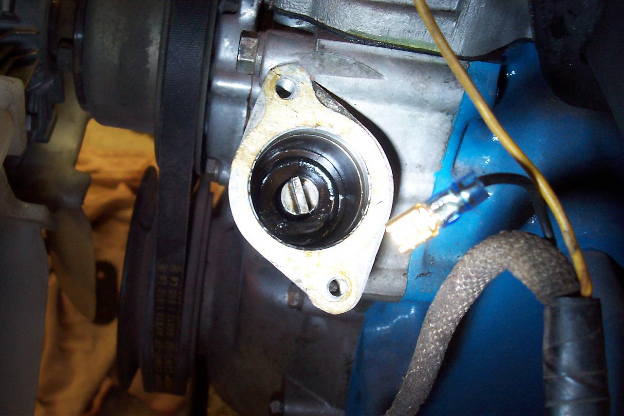

I think I found the problem..looks like I'm a tooth off on the drive gear. I'd love some input before I drop the oil pump, this is my first time with the Z, but that looks off doesn't it? Thanks for all the help.

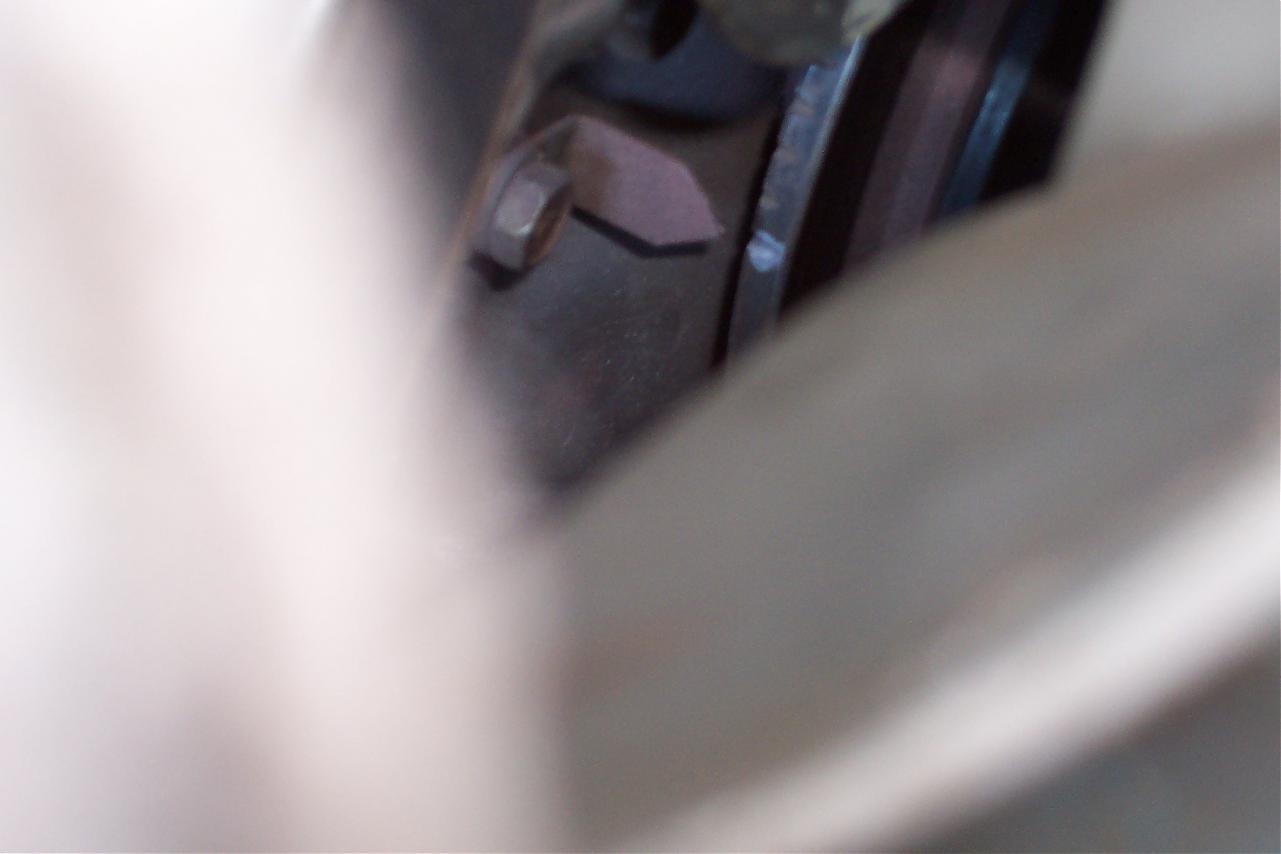

The other pic is the crank pulley, right at TDC.
Now its a little better, but not quite right. If I retard the dizzy as much as I can it'll run, but not like it should. I think, since I have to retard the dizzy all the way, maybe I went 1 tooth too far.
Are you thinking I went too far the other way also?
Thanks alot Stephen. You were actually the guy I was hoping to hear from. I'm gonna pull the oil pump right now, I'll post another pic of it after I re-adjust and before I re-install the dizzy.
