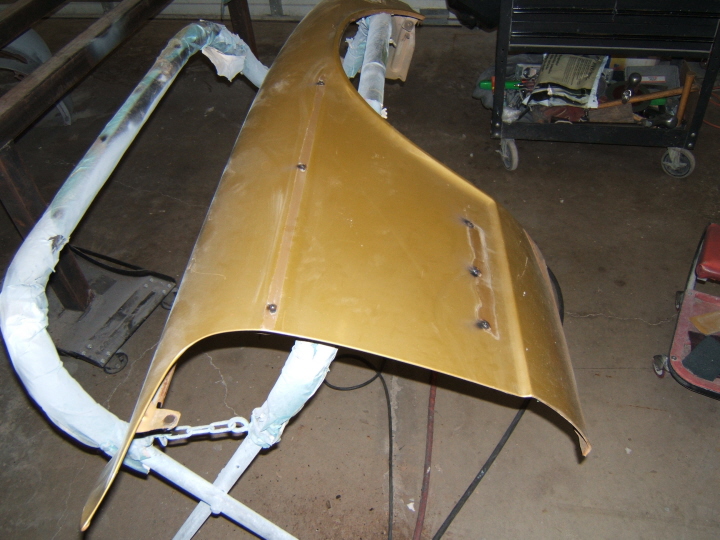

January 31, 200817 yr Author comment_235878 Nice work. One question, what did you fill the holes that were left behind when you removed the side moulding with, solder or body filler? For the best results, I used a MIG welder to fill the holes on those side moldings, as well as the holes for the fender emblems and rear hatch emblems. Afterwards, I used a disc grinder to make it smooth and then used some body filler to take care of imperfections. I also undercoated the back side to prevent corrosion. Link to comment https://www.classiczcars.com/forums/topic/26914-my-260z-painted-and-assembledfinally/?&page=2#findComment-235878 Share on other sites More sharing options...
