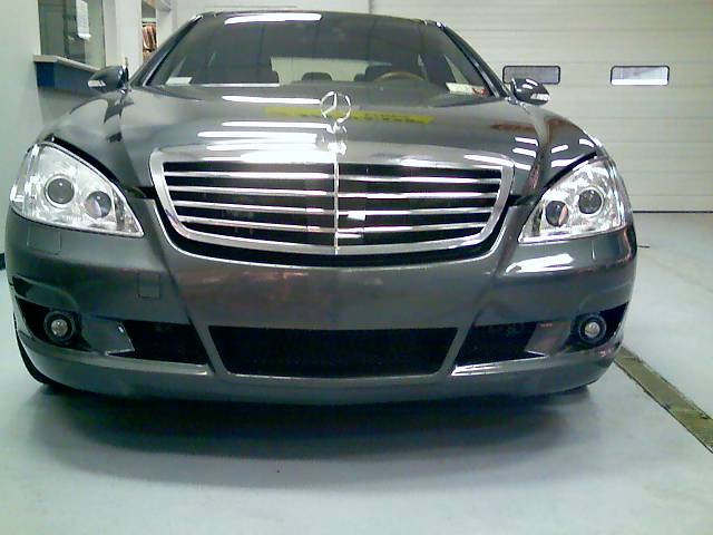

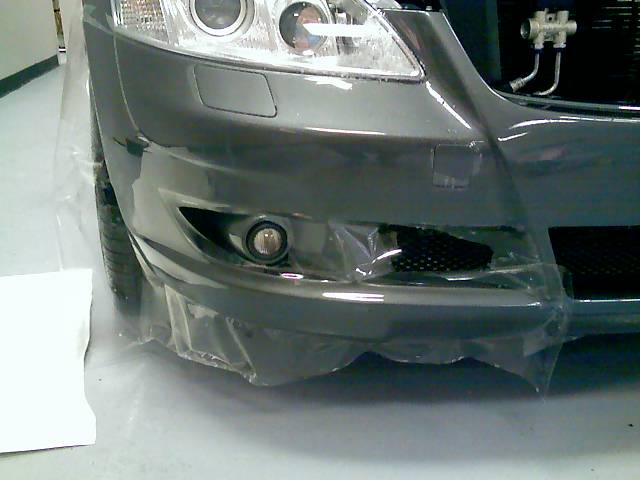

Below is a free hand job on a Benz. It was an aftermarket bumper with no pattern.

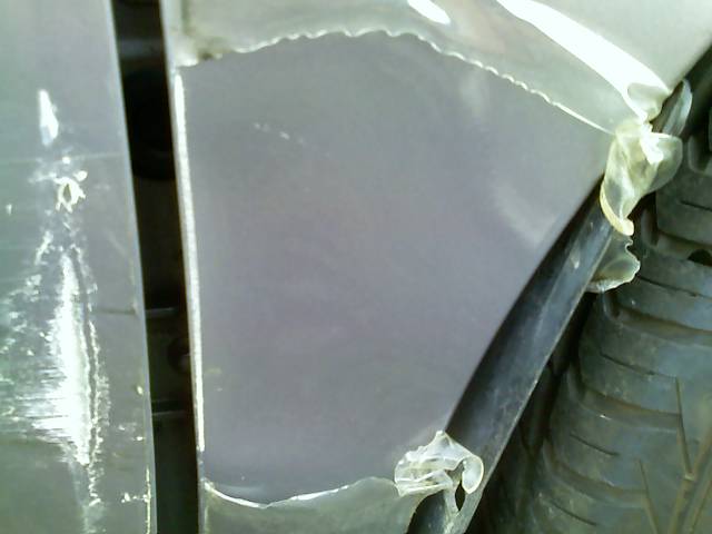

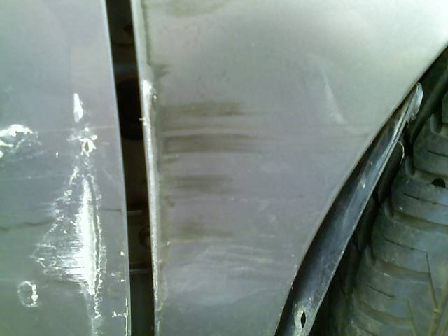

Here's some more pictures. The first two is my car after some jackass hit me. The fender is destroyed, but the paint was protected! The second is another brand of film that was on a car for less than a year. It's BLACK!!!
