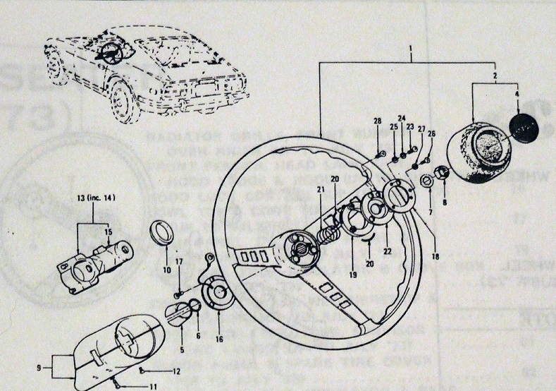

Posted February 13, 200817 yr comment_236938 I need to know the order of how the horn spring and various metal and plastic rings go back together to make the horn work. I have been looking everywhere, i have manual but it doesnt go into detail of the spring reassembly, any help in simple english would be greataly appreciated:cross-eye Link to comment https://www.classiczcars.com/forums/topic/27032-horn-spring-reassembly/ Share on other sites More sharing options...

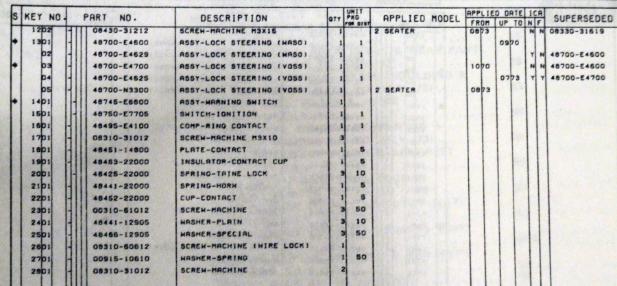

February 14, 200817 yr comment_237030 Your question was a bit vague (240Z I am guessing & don't know what year)... is this what you are seeking? This is for a 240Z mfg. dates up to July, 1973. This is about as straight-forward as it gets - pictures. Straight from factory parts catalog (r. June 1974). I hope it helps. Link to comment https://www.classiczcars.com/forums/topic/27032-horn-spring-reassembly/#findComment-237030 Share on other sites More sharing options...
February 14, 200817 yr Author comment_237125 Thanks John, yeah i always forget to say i have an early 73 240z, this picture is perfect ty Link to comment https://www.classiczcars.com/forums/topic/27032-horn-spring-reassembly/#findComment-237125 Share on other sites More sharing options...
