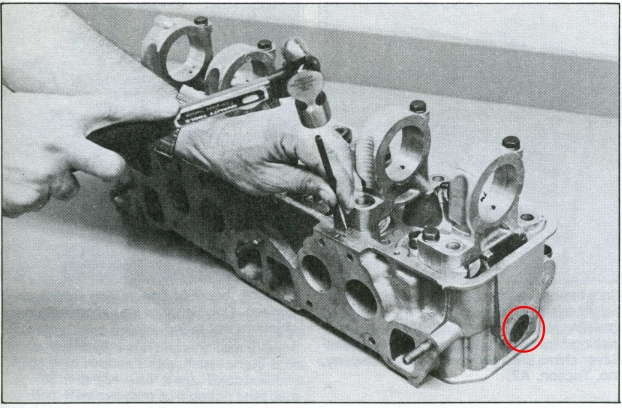

I assume the coolant is not exiting from inlet or exhaust passages?
There is a welch[freeze] plug at the rear of the alloy head that could be the culprit, although they are normally all replaced when a head is reconditioned:disappoin.
The plug may have a hole rusted in it and it has started leaking under pressure:nervous:
