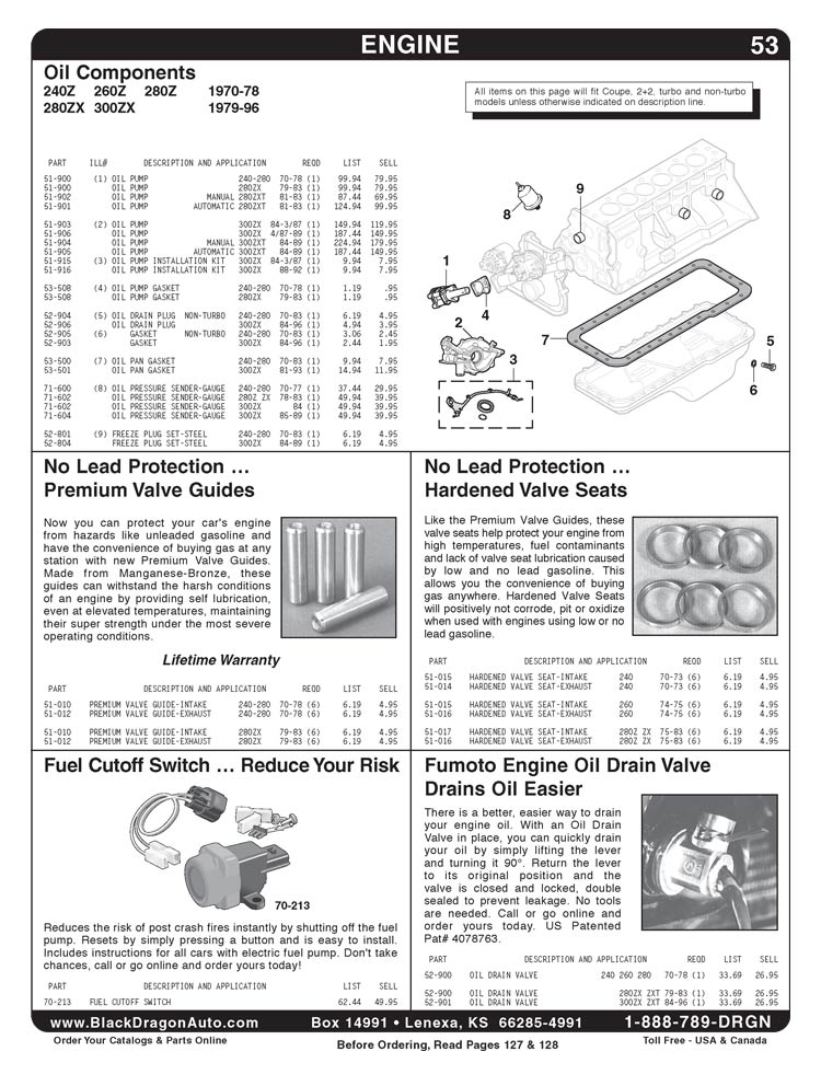

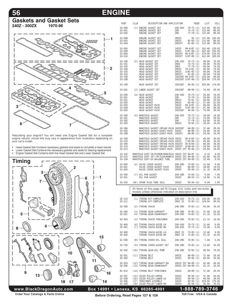

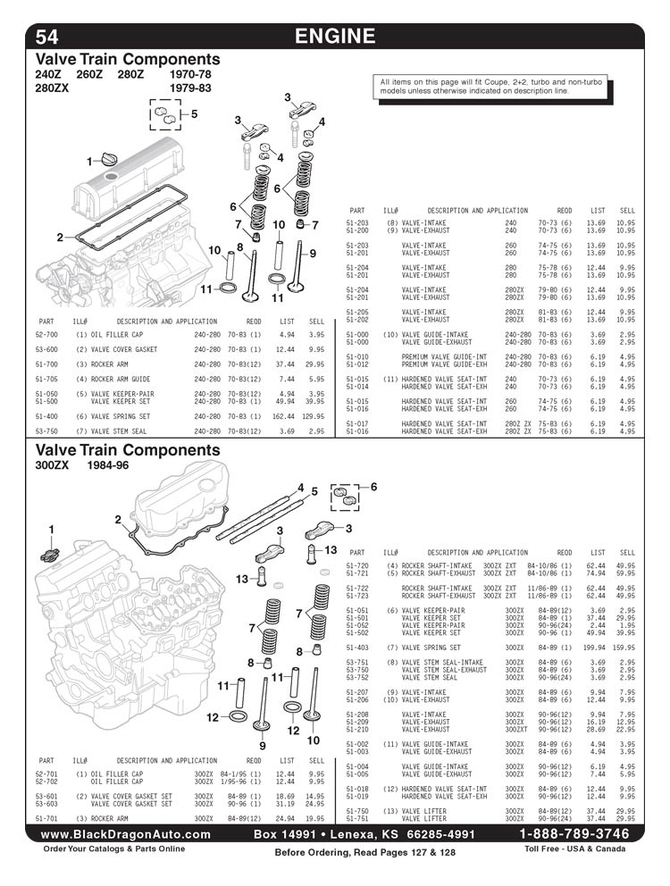

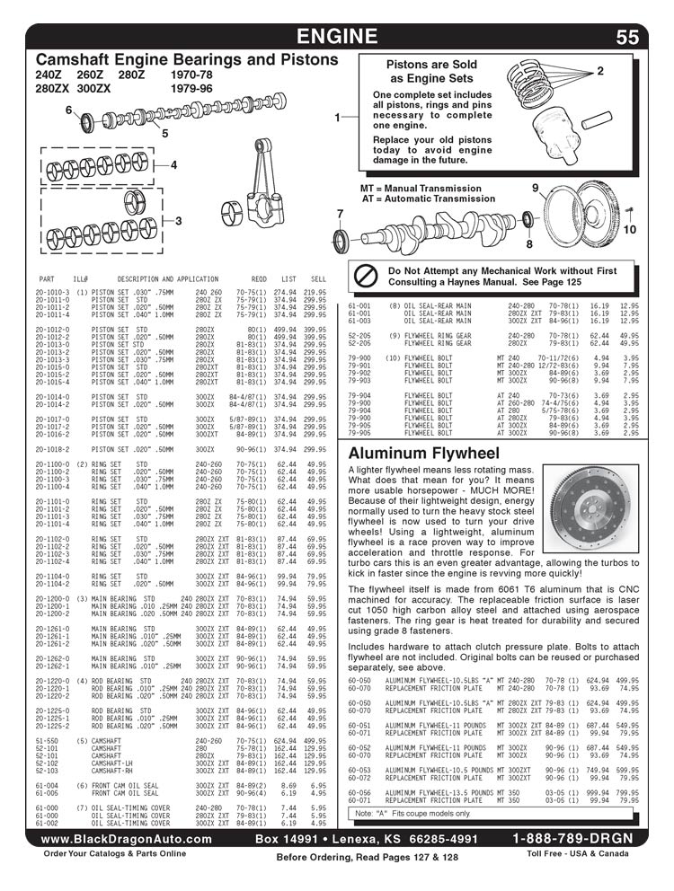

There are several places for you to shop for the parts you might need. I am posting these pages as an example. Shop around, you may find better deals.
These are pages from www.blackdragonauto.com , though as I said, there are other places to order from.
