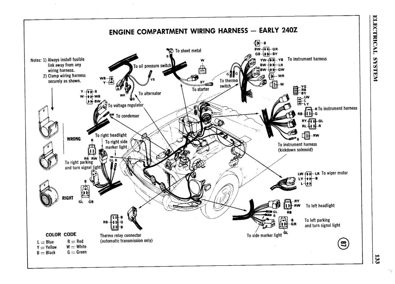

February 25, 200817 yr Author comment_238572 Here are some pics of the replacement dash harness (pics 1 and 2) and the original engine harness (pic 3) it needs to couple with. You can see the different connectors. Can I mate these up with the right connectors? Link to comment https://www.classiczcars.com/forums/topic/27179-dash-wire-harnesses-differences/#findComment-238572 Share on other sites More sharing options...
February 26, 200817 yr Author comment_238577 Here are some more detailed pics with the wires from the dash and engine harness connected as much as possible. The numbers are on the engine harness. Link to comment https://www.classiczcars.com/forums/topic/27179-dash-wire-harnesses-differences/#findComment-238577 Share on other sites More sharing options...
February 26, 200817 yr comment_238588 Ok, before I get too detailed on the photos, take a look at the following pics and see if that helps get a few more connected. E Link to comment https://www.classiczcars.com/forums/topic/27179-dash-wire-harnesses-differences/#findComment-238588 Share on other sites More sharing options...

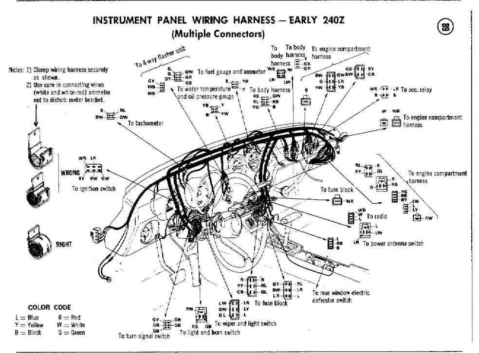

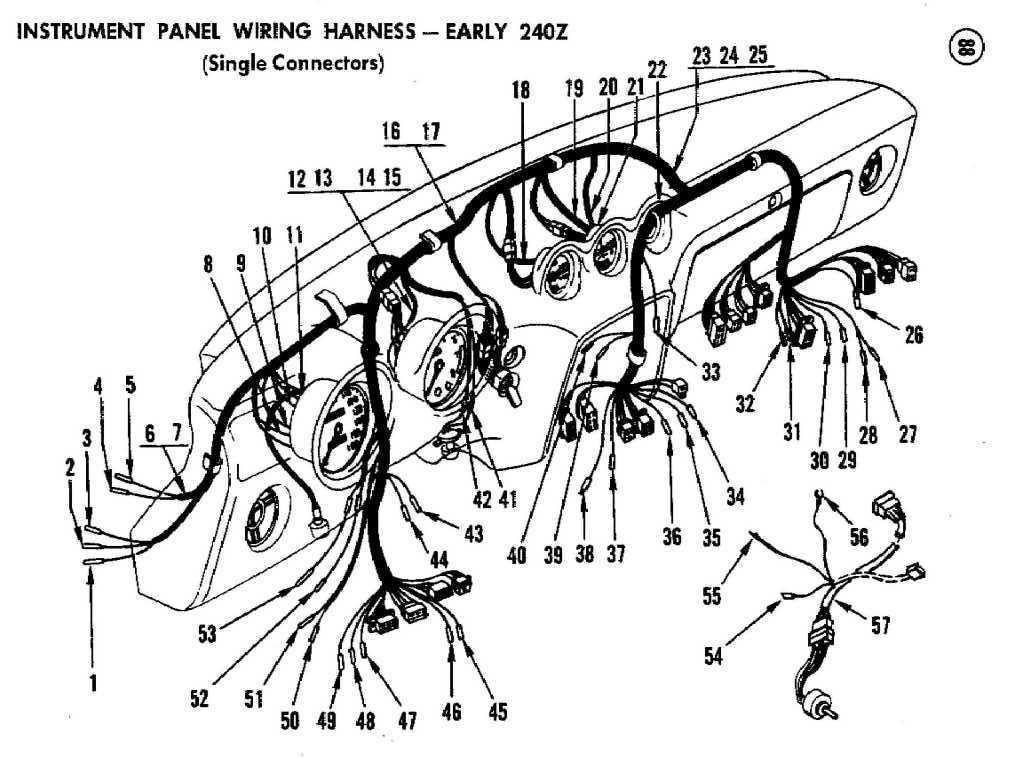

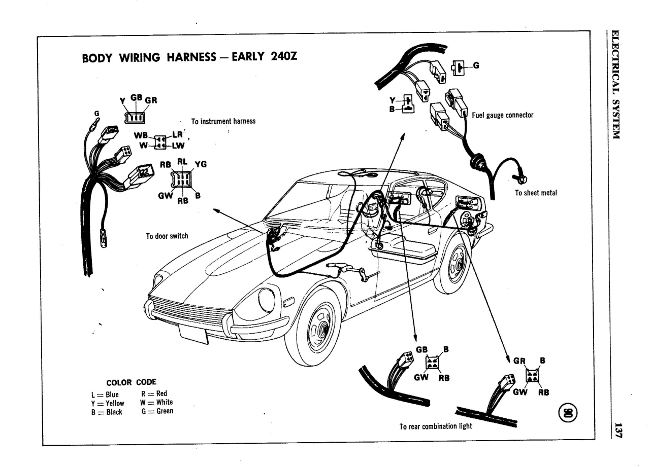

February 26, 200817 yr comment_238592 I'll be out early tomorrow, but when I get back in the evening, I'll continue. Unfortunately, that means I have to make it an early night tonight.Hopefully the pages I posted from the Clymer's helps figure out a couple of them.I also note that in a couple of the photos there are already what appear to be some matched numbers, i.e. 1 and 1; 2 and 2; and a 4 and 4. From what I can tell those DO match colors on both sides of the connector and the connector should mate up. Still working on others.This one is tricky, any other sharp eyes out there?E Link to comment https://www.classiczcars.com/forums/topic/27179-dash-wire-harnesses-differences/#findComment-238592 Share on other sites More sharing options...
February 26, 200817 yr Author comment_238631 Thanks, E and Geezer, am out of state until tonight will review the diagrams versus my car and see what I can do.Geezer, at this point I have a potential replacement wire harness in great shape, whereas my original is not so great. Trying to see if i can modify it to work, might be easier than patching up my existing harness.E, the numbers are from the old dash harness and engine harness behind the replacement harness. I numbered them when I took the dash off for restoration and pulled the harnesses apart. Link to comment https://www.classiczcars.com/forums/topic/27179-dash-wire-harnesses-differences/#findComment-238631 Share on other sites More sharing options...
