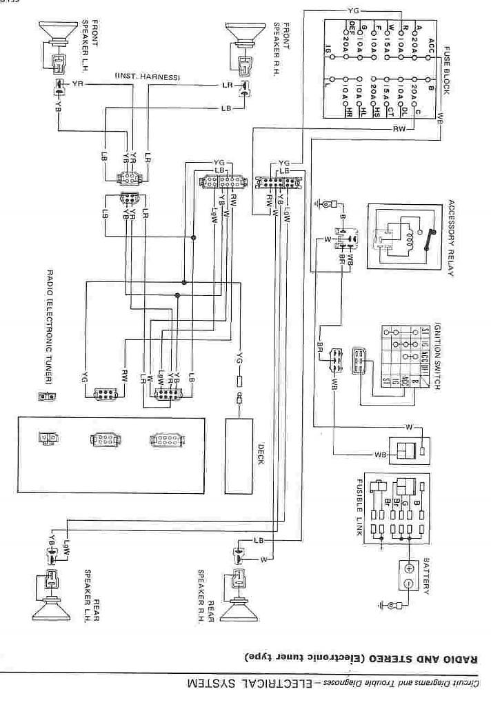

Posted February 26, 200817 yr comment_238624 guys i am going to kill myself here ive been looking for three days for an audio diagram to tell which wires are which from the factory radio wiring harness some duche bag jerry rigged an aftermarket sereo into it and im trying to fix it also i cannot find an adaptor for the factory wiring harness for an aftermarket head unit installation...any help guys???? Link to comment https://www.classiczcars.com/forums/topic/27188-1983-datsun-z-audio-wiring-diagram/ Share on other sites More sharing options...
February 26, 200817 yr comment_238653 Here is a scan of the factory service manual wiring diagram. I hate when the hacks do that!! It's so easy with the proper adaptor Try www.crutchfield.com or www.metraonline.com for wiring adaptors Good luck! Link to comment https://www.classiczcars.com/forums/topic/27188-1983-datsun-z-audio-wiring-diagram/#findComment-238653 Share on other sites More sharing options...

February 27, 200817 yr Author comment_238800 Awesome, thanks.... this manual was not up there a couple of days ago on carfiche.com that is. Link to comment https://www.classiczcars.com/forums/topic/27188-1983-datsun-z-audio-wiring-diagram/#findComment-238800 Share on other sites More sharing options...
