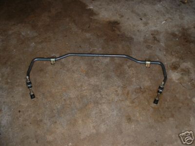

I have attached a picture of a sway bar like mine. It goes in front of the diff. The two brackets (and bushings) I need are in the pic attached to the bar. It may be aftermarket, I have no idea. Any help apreciated...
You may be better off going with a setup like this... But if you really want to use what you have then I'd suggest welding brackets to the frame before drilling into it as one of the the posts below advise.
You'll probably have to fabricate the brackets yourself or get a machine shop/welding shop to fab them for you. Good Luck...

FYI... You do not want to drill into your frame rails on your Z. The sway bar mounting points have captive nuts inside of the frame rail. You do not want to drill through the rail either, as you will crush the rail when you tighten the bracket bolts.
