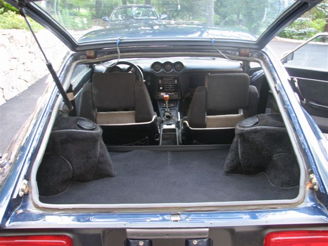

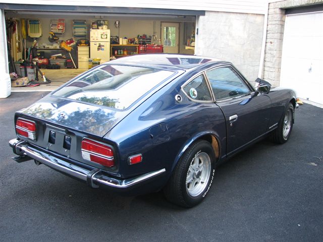

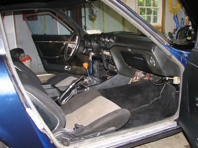

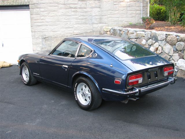

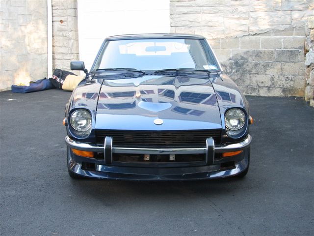

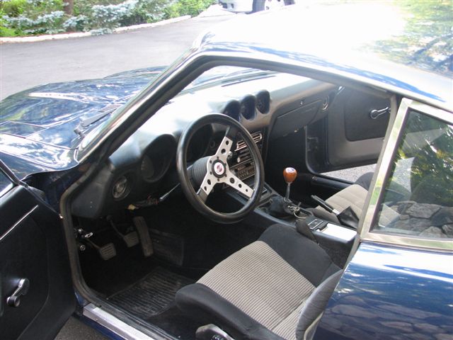

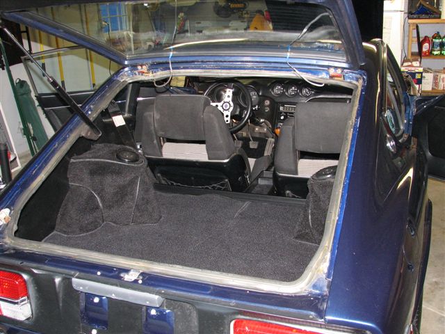

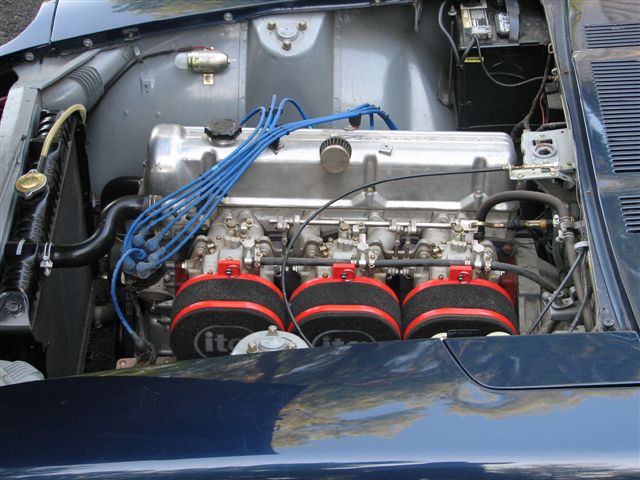

March 4, 200817 yr Author comment_239338 Ok, I'm going to try and post a bunch of the pictures of the car in question. Opinions are appreciated either in the thread or via pm. Thanks! Link to comment https://www.classiczcars.com/forums/topic/27231-looking-at-buying-a-240z/?&page=2#findComment-239338 Share on other sites More sharing options...

March 4, 200817 yr comment_239344 Like I said - everything is OK for a Street Modified Z - but it can't be judged for "value" against a value guide for Classic Cars... Work done 16 years ago - may need a lot of rework by now.Picture #1Dash Cover - cracked dash ($850.00)Wrong Seats - rebuilt, recovered OEM seats - $400.00 by the time your done at leastWrong Carpet set - 280Z Carpet covering the correct diamond vinyl.Wrong Steering Wheel ($150.00 restored - maybe $50.00 used)Wrong Shift Knob... $75.00 OEM replacement in show conditionPicture #2Wrong rear carpet - correct diamond vinyl covered or missingLooking at the hatch hinges - was this car originally Orange?Picture #3Wrong Wheels...not period correct for a 240-Z, even if non-OEM hubcapsRear Deck emblems missing $150.00Engine Compartment Picturenon body color - and a very sloppy paint job - no attention to details.. It would take a lot of effort to straighten this out at this point.don't know if it still has the original engine or not...?????painted over the plastic air intakes, shock covers,painted over the accelerator linkage - uckpainted over the hood support - uckpainted over the brake vacuum booster - uckmissing OEM fuel filter & holder...(not unusual for triples, but not stock)Red Block - uckElectric Fans - missing stock fan...Body:Black-out or missing stainless trim on both windshield and rear windowFWIW,Carl B. Link to comment https://www.classiczcars.com/forums/topic/27231-looking-at-buying-a-240z/?&page=2#findComment-239344 Share on other sites More sharing options...
March 4, 200817 yr comment_239347 OK take a mangnet when you look at this car some things look to smoothe not to have a lot of bondo. some of the details are missing or not a pronounced. On the rear deck-lid and the rear lower pannel you should see the spot welds check her with the magnet also feal the back panel on the inside, and see if it has the right shape. the price and the look of the car just tells me something might be hiding. The orignal seats are not to bad to find and they make the foam and vynle so all you need is a good seat frame. I'd recomend holding off, and doing some reaserch on the Z cars I'd recomend for a daily driver getting a 280z. They are not as fast, but have fuel injection and are easer to maintain and get parts. I know they look the same, but take it from me they are not as interchangeable between 240z(s) and 280z(s). The other advantage to the 280z is that they made alot more of them and are easer to get parts. I would recomend a 240Z if it is not a daily drive and more for enjoyment, they are faster, but they take more work to keep running, prone to rust out easer, and harder to pass emmisions compaired to the 280Z. Stay clear of the 260z not a lot of good things unless you need a shell to build a race car, or have a 240z and need parts that match. Not to say the 260Zs are not nice, they just don't compair to a 240 or 280 in proformence and have the same maintence of the 240. I hope this will help, also check out at the libruary "How to Restore Your Datsun Z-Car" by Wick Humble, it might help on what to look at on the car, it is not one you need to buy, but is has good diagrams of rust locations and things to watch out for when buying a 240-280Z Link to comment https://www.classiczcars.com/forums/topic/27231-looking-at-buying-a-240z/?&page=2#findComment-239347 Share on other sites More sharing options...
March 4, 200817 yr Author comment_239349 I actually bought the Wick Humble book. I was a little disappointed in the level of detail but I don't see me restoring a car so it's mostly for light reading.As far as the car in question here I'm beginning to lean away from it. Carl points out a lot of things about the car that move it away from stock although with all due respect Carl, I don't think a well put together modded car automatically drops it to basement levels. Maybe you didn't mean that but that was the impression I got. I do want to thank you for your keen eye though.The reason I'm leaning away from the car is that I want a 240Z that is for all intents and purposes stock in the interior and exterior with aftermarket wheels. Sorry the original hub caps look blah. Besides that, triple carbs, rebuilt 2.8 block, etc under the hood is just fine with me. This car just strays too much from that and although I think I can get him down quite a bit from $12K I just don't think the car satisfies my nostalgic side for the old 240Z. Link to comment https://www.classiczcars.com/forums/topic/27231-looking-at-buying-a-240z/?&page=2#findComment-239349 Share on other sites More sharing options...

March 4, 200817 yr comment_239389 I agree with Carl's thoughtful commentary above. When someone modifies a car like this, they are applying their tastes (or lack thereof) to the car, and those tastes will not suit everyone who is a potential buyer of the car.I would never put those ugly seats in my Z, for instance. And I would never carpet over the diamond vinyl, etc....just my opinion, and my opinion isn't worth much. But just to give you a 'fer instance', this car would not interest me as much as an unmolested car would.It looks pretty clean, but $8K-$10K sounds about right, depending on the buyer. Link to comment https://www.classiczcars.com/forums/topic/27231-looking-at-buying-a-240z/?&page=2#findComment-239389 Share on other sites More sharing options...
