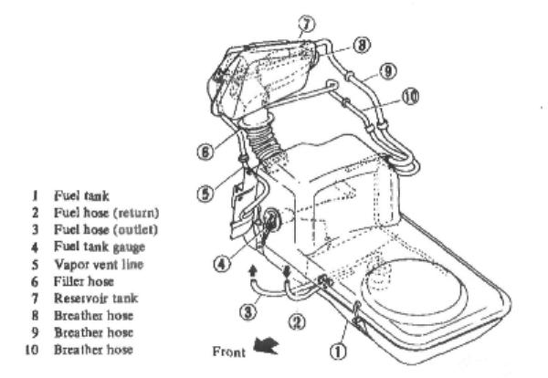

Thanks Stephen, that diagram was what I needed too. I could not find it in my manual. It gives me a better idea of what those lines are for. Thanks again.
I will punch that hole in and put the filter as Zspeed mentioned... and vavooom!. .. well, lets see eh!
