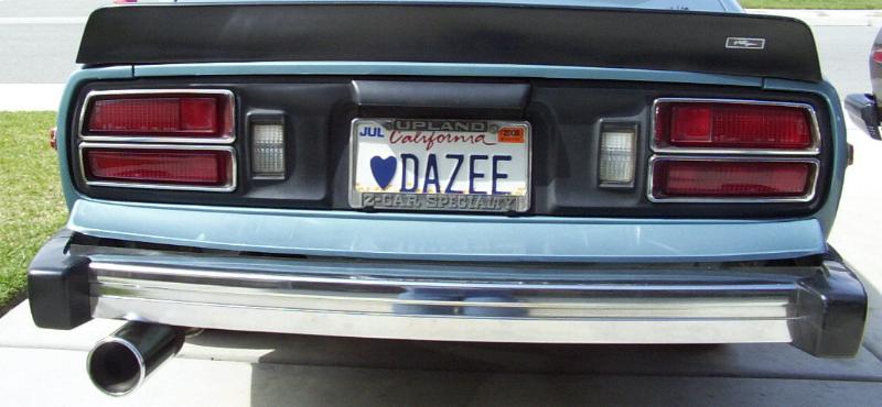

Someone asksed the same basic question about a 78 the other day. If you talking about that bumper bar type thing, that was a dealer add on/aftermarket add on. There's not set spot or template for something like that. Just line it up to where you think it looks best and mount it.

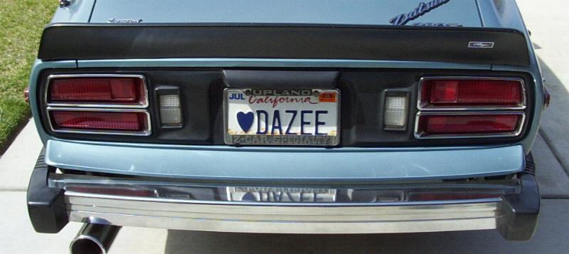

Oh, the 'sightshield' as Nissan called it. Sorry about that. You did say the 'shield over the bumper' so I badly misinterpreted that. The corners are flush with the bottom of the tail light finisher opening and the center is about 1/2 below the opening. Would a picture help? Mine has never been hit so I'm sure it's where it's supposed to be.
