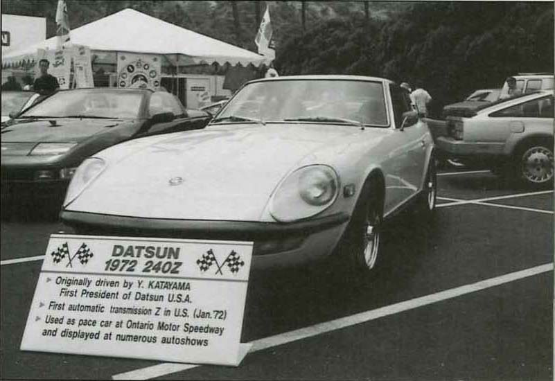

August 16, 200816 yr comment_256842 I came across this old picture of Mr. K's Z being shown at the 1994 National Z convention in San Diego. I was surprised that the display sign indicates this is the "first automatic transmission Z in the US (Jan '72)". I wonder what all the 1970 and 1971 Z owners with automatic transmissions at the show thought when they saw this? -Mike Link to comment https://www.classiczcars.com/forums/topic/27345-whats-the-earliest-auto-z/#findComment-256842 Share on other sites More sharing options...
