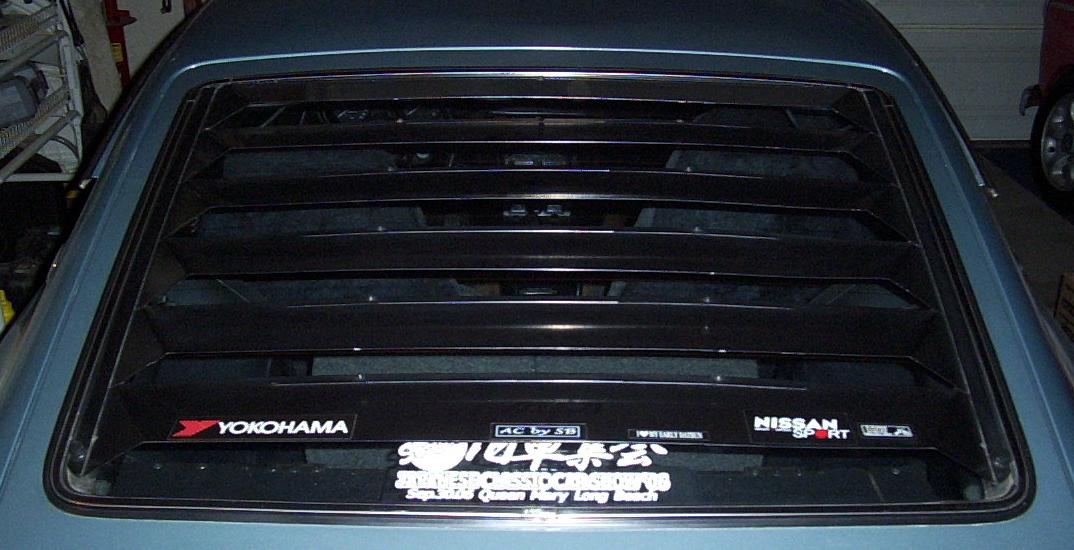

I have the Chastain 'Shadow' louvers on my 78. They are aluminum and dont have a center rib. They have 2 rubber insulators on each of the five lower louvers and one in the middle of the top one. They are mounted without drilling and they don't rattle. They have a prop rod on either side to hold them up for cleaning the rear window. They were dealer installed in 1977 at as per the P.O. at Ontario Datsun and have done no damage to the window in those roughly 30 years.

The rubber insulators mentioned above - how do they attach? I just got the louvers off ebay and they do not have the insulators mentioned. Yes, they are the Chastain Shadow louvers - decal is still on them. Any thoughts as to what could be used in place of the original insulators? Thanks in advance for ideas. -Bill-
They just press into the holes in the louver. If you look at the attachment in post #6 you can see two of them at the top of each of the five lower slats about 10" or so on either side of the center. I don't know where you'd get replacements...maybe a hardware store?
I like the looks of the curved ones better than the Chastain, but no way would I drill holes in my tailgate for louvers, so if I were to add a set they'd have to be Chastain or some other brand that mounts the same way. Not real high on my priority list, but if I ever stumble across a set...
I have the shadow shade with the two rubber cushions per slat, but after years of sun on it the rubber had dryrotted. What I did was cut some aquarium air tube about an inch long with a slit on one side and sliped it onto the slat where ever a cushion was.
"They just press into the holes in the louver." - SBlake01 - That explains the notch in each louver at the location yours has the "button".
