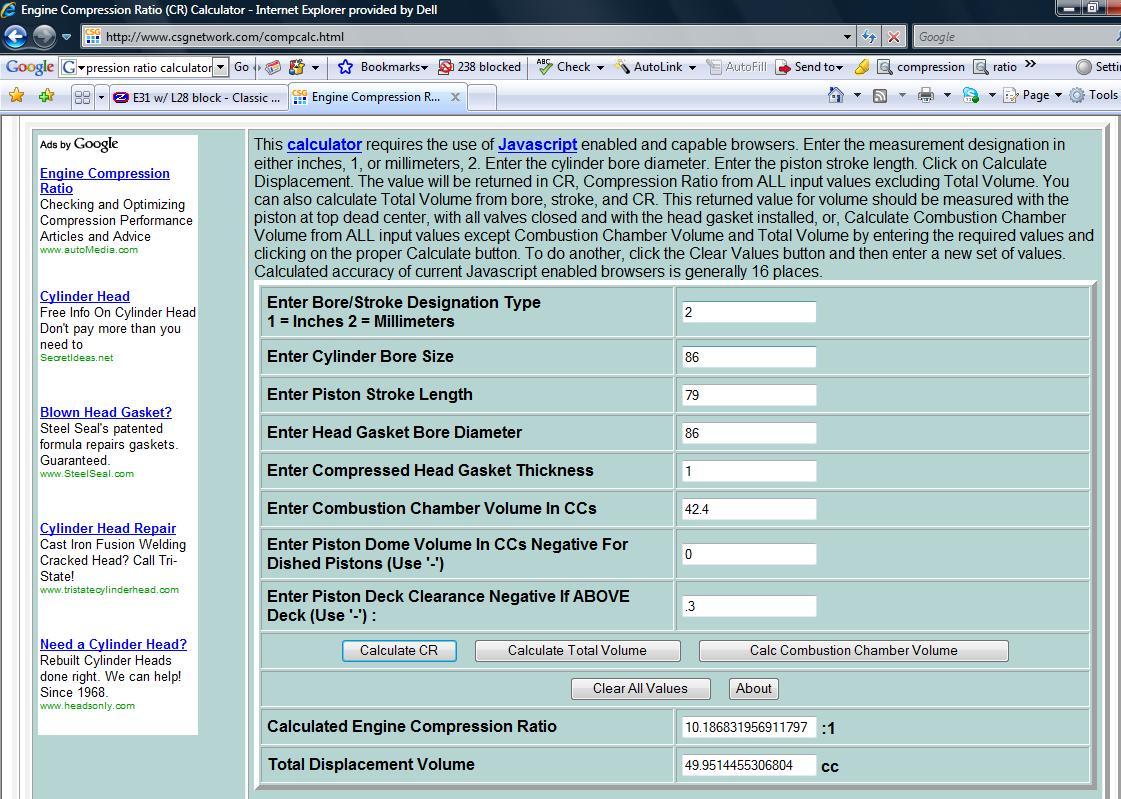

March 21, 200817 yr comment_241321 L28 – Flat Top Pistons (79-83) & E31 Head Swept Volume of Cylinder = 458.9 Combustion Chamber volume = 42.4 Gasket Thickness = 7.7 Deck Height = -3.69 505.31/458.9 = 11.1 C/R with a positve deck height 509.0/458.9 = 11.09 C/R with 0 deck height FWIW, Carl B. OK, I'm still not sold on the calculated compression Carl stated above. Please see the attached image and verify if I'm way off regarding input into the calculation program. I guess-timated a deck height of -0.3mm which I believe should not be too far off for stock flattop pistons and used a gasket thickness of 1mm to come up with the 10.2:1. Here's the link since as it's not very clear on the image: [email=http://www.csgnetwork.com/compcalc.html]http://www.csgnetwork.com/compcalc.html Mark Link to comment https://www.classiczcars.com/forums/topic/27394-e31-w-l28-block/#findComment-241321 Share on other sites More sharing options...

March 23, 200817 yr comment_241550 Hi Mark:Most of the guys seemed to agree that the L28 head gasket was 88mm - you have 86. I also get 1.27mm for the compressed height of the gasket .05 inch or 1.27mm. You are using 1mmAlso you have a piston deck clearance .3mm - ie. below the deck - - all my notes say it should be .-0.741 above the deck. I was using -0.3 by mistake as that is for a 0.5mm overbore.FWIW,Carl B. Link to comment https://www.classiczcars.com/forums/topic/27394-e31-w-l28-block/#findComment-241550 Share on other sites More sharing options...

March 23, 200817 yr comment_241584 Carl, they have pull down menus that you select and it inputs the correct data.Block: L28Crank: L28Head: E31Rods: L28Pistons: L28 Late (this will be flat tops)Cam: L28Gasket Height: 1.2 mm - stock gasket height Link to comment https://www.classiczcars.com/forums/topic/27394-e31-w-l28-block/#findComment-241584 Share on other sites More sharing options...

March 25, 200817 yr comment_241738 OK, I'm still not sold on the calculated compression Carl stated above. Hi Mark:Yes- and it's a good thing too. I totally screwed up the calculations - I must have been falling asleep or having as Senior Moment..Had time to go back through this - to see why such difference.... between my calculation and the Web Based Speadsheets...Holding the Deck Height at "0"... as there seems to be some disagreement to the actual data being gathered.... I should have written:L28 - Flat Top Pistons (79-83) & E31 HeadSwept Volume of Cylinder = 458.9ccCombustion Chamber volume = 42.4ccGasket Volume = 7.7ccDeck Height = 0558.9 + 42.4 + 7.7 = 509and42.4 + 7.7 = 50.1so 509 divided by 50.1 = 10.16Thanks for catching that... Mark/Bo...FWIW,Carl B. Link to comment https://www.classiczcars.com/forums/topic/27394-e31-w-l28-block/#findComment-241738 Share on other sites More sharing options...
