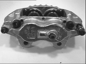

August 24, 200222 yr comment_13948 For what it is worth Hi, Because these callipers are too heavy to send to Holland or any place else, I hunted them down here in Holland at the local store at least I think I got them. I've you have a good look at the calliper you will find the mark S12 on it. That’s the mark where all the experts talked about in there stories. Below are the models from Toyota which have the callipers on, but I think Toyota prices are high! These are remakes; they told around 145 euro that’s about us$140. They are from Hitec. HI-LUX 2.2 4X4 YN106/110 MOT.4Y 69KW 01-89 4-RUNNER PICK-UP TYPE N13 01-90 12-93 LANDCRUISER 2.4 4CIL RJ70 MOT.22R 81KW 03-86 03-90 Link to comment https://www.classiczcars.com/forums/topic/2740-4-piston-brake-conversion-questions/?&page=2#findComment-13948 Share on other sites More sharing options...
