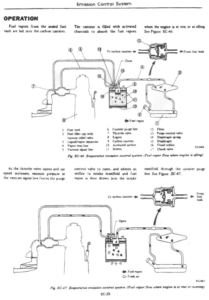

The first thing was about the carbon canister and more generaly the vapor system. Obviously I don't have any.

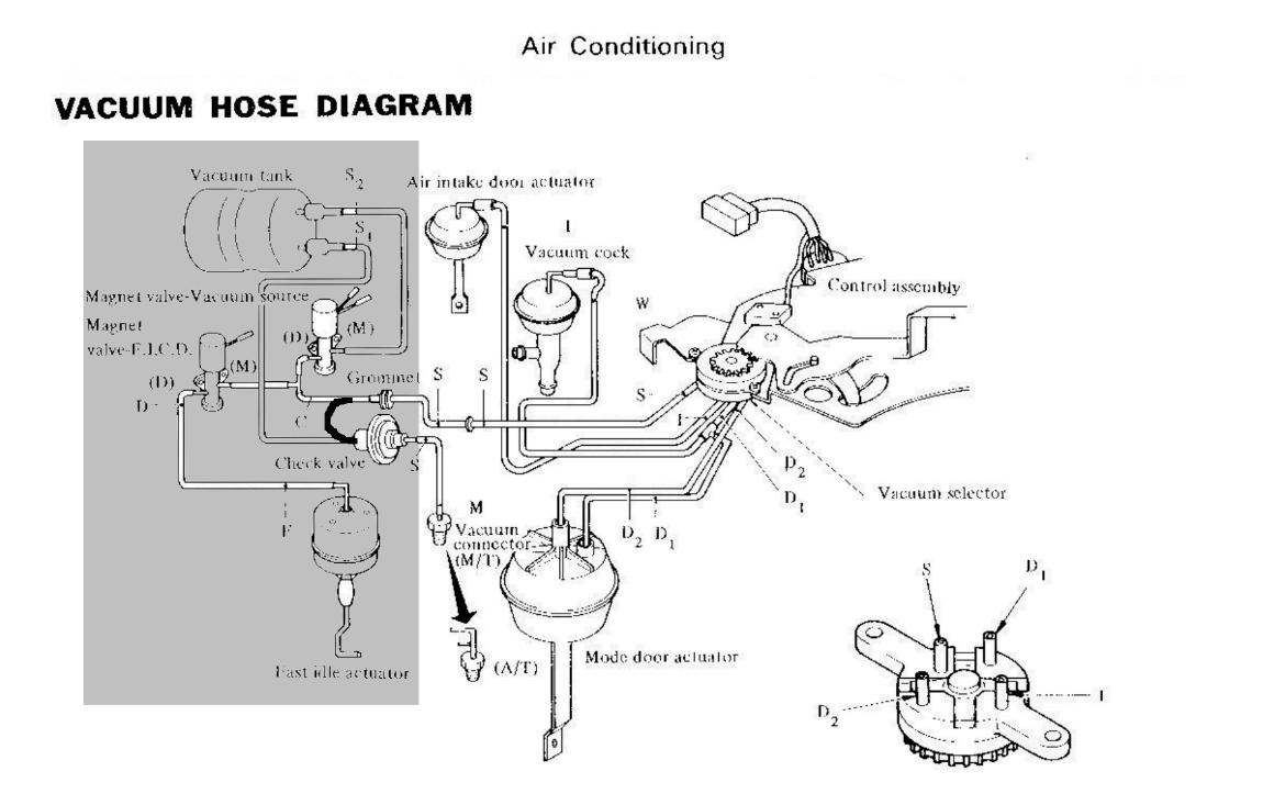

I join a photofraph of my engine (not running, don't panic :)) and a scheme of the vacuum system. It might be easier if we use the same words (those on the scheme) and if we wright on these two papers.

Connect the line "S" to the check valve as shown by the black line I added to your scheme and remove everything in the shaded area. That will eliminate the A/C part of the vacuum system and leave your vent door controls intact. As far as the vapor sytem is concrned, I wouldn't remove that.
I wonder if the vacuum tank is not usefull as a buffer zone (no man's land...sorry I don't exactly know how to translate the french word "tampon" which can meen a lot of things...).
And if you remove the "magnet valve vacuum source", this means the "vacuum connector" is always connected to the heater system (right part of the scheme). Doesn't this matters? What controles this magnet valve exactly? When does it opens or shuts?
Last question: can you show me (on the photograph of my engine or on an other one) what is the check valve?
Thanks a lot. Your are realy helpfull :)
The magnet valves and vacuum tank are part of the fast idle control system. That raises the engine idle speed when the air conditioning is on. You won't need them if you don't have a/c. I don't see the check valve in the picture of your engine. It's a round plastic one way valve with an inlet and outlet. Vacuum will only pass through it in one direction. Looks like a few things are misssing/disconnected on your engine.
