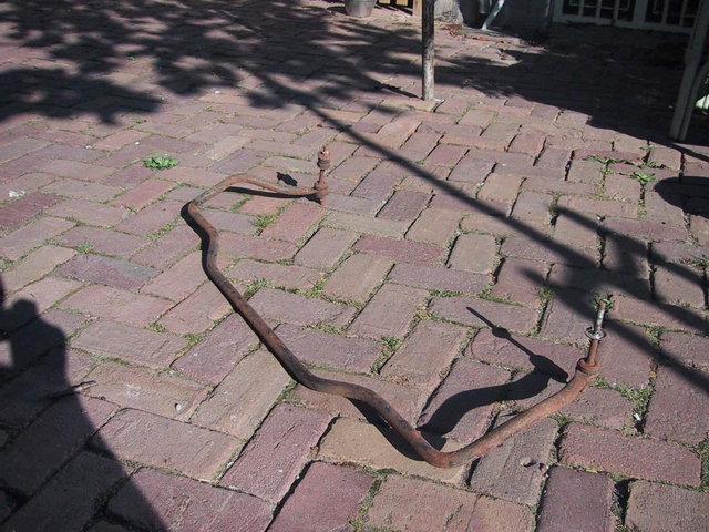

September 3, 200222 yr comment_14710 Well, I had a look under my car but Im not quite sure what to look for :stupid: How hidden is teh bar? Look for this. I also heard another story: if you use stiffer bars (24mm/more) they can ruin you shell. The connections come lose from the shell?? Falls or through? Link to comment https://www.classiczcars.com/forums/topic/2748-rear-sway-bar/#findComment-14710 Share on other sites More sharing options...

September 3, 200222 yr comment_14721 The picture of the under carriage sway bar shows and aftermarket one. It is the one most tuners will tell you to put on. It doesn't put a load on your underbody like the factory ones. The above picture of the rusty sway bar in the driveway looks like the Nissan one. That one looks like it fits in the factory 240 frame mounts. The US late 260 bar won't fit in the US market 240 mounts, its longer and doesn't have the bent to clear the diff housing. I tried pulling my 260 one and fitting it to my 240 . Link to comment https://www.classiczcars.com/forums/topic/2748-rear-sway-bar/#findComment-14721 Share on other sites More sharing options...
