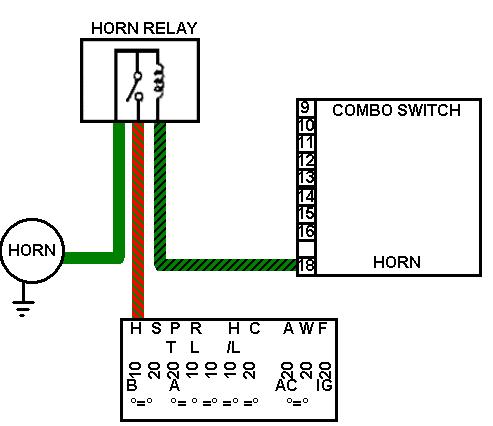

that's a horn relay.
Green/red is power from the fusebox
green/black is contact wire from the horn button
Green wire is directly to the horns.
try looking for a replacement relay (ask around) or find out which one is drawing.
Dave.
Carlos, change the contact that gets closed from the Green/Red wire to the Green wire, otherwise you'll never get that horn to blow.
Also, when you draw the diagrams, note that the wire color pairs you use should be distinctive as to Primary and Identifier Stripe. As your diagram is drawn they could be read as either Green/Red versus Red/Green or Green/Black versus Black/Green. All 3 wires at the Horn Relay are primarily Green with an identifier stripe, hence Green/Black or Green/Red and not the other way around. In otherwords, make the identifier stripe a smaller band of color to identify it as the stripe.
