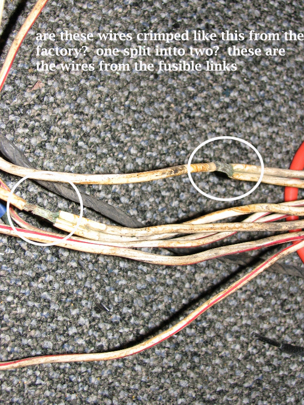

Hopefully this will answer some of your questions in the pictures:
Img-1962 (the first one on the Left)
The pic detail gets lost in the corrosion, but if it is a brass "sleeve" that the wires are inside of that is then crimped, then YES it is a factory connection. These were used instead of soldering. Clean them off with a soft wire (brass) brush then re-tape.

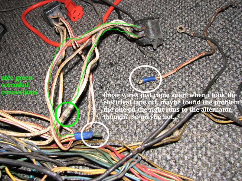

Img-1962 (Middle)
Green corrosion is common with brass/copper. Clean off with brass wire brush and re-tape. Liquid electrical tape is ok, but it takes hours to cure.
A White/Red wire DOES connect to the Alternator directly from the fuse box, it's the Secondary power feed to the extra circuits and wouldn't normally be the reason for not starting. (Ignition is on the Primary power feed, the White wire to the Fuse Box.) The two wires are probably one for the fuse box and the other for the Ammeter.
