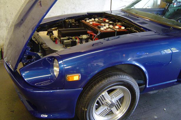

Jmead, How is all that weight in front of the front axle line going to affect the handling?
How heavy are those batteries?
  Mr Camouflage said:
Of course, goes without saying.
There are 8 batteries up front, weighing 60lbs each, this is only 480 lbs. About the same as the engine they replace

  Derek said:
WOW great progress James!
You know you could always use the loop of cable on the middle batteries in the passenger compartment (blog pic) as a cup holder.
Thanks again for sharing this with us.
Derek
Hehe, it is kind of asking for a cup. I wish I didn't have to make it so obtrusive, I will have to see about changing that in the next revision.
Better pic with more progress:
dscn2025.jpg?w=400
