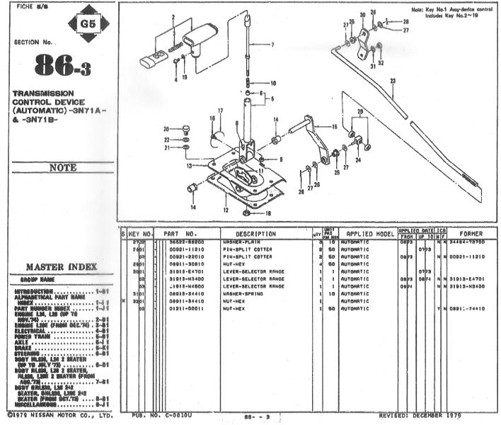

April 7, 200817 yr comment_243253 Here is the info. I couldn't post earlier, too may pixels it turns out:finger: Link to comment https://www.classiczcars.com/forums/topic/27646-auto-transmissionstarting/#findComment-243253 Share on other sites More sharing options...

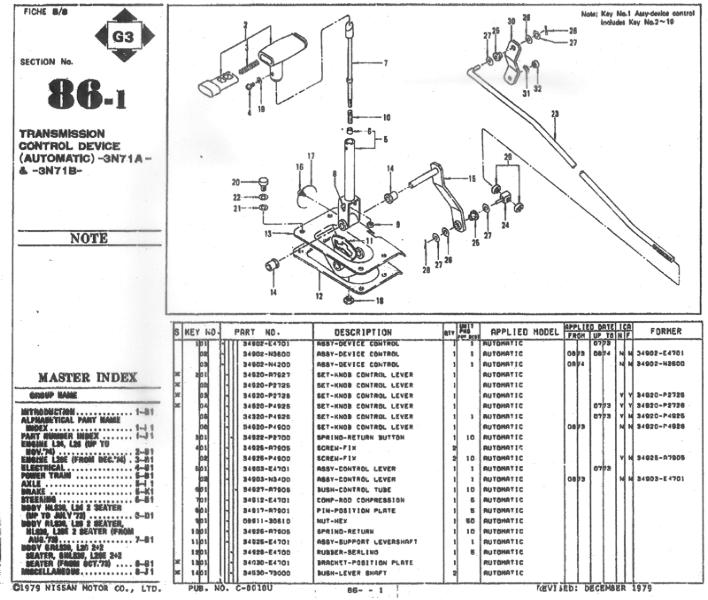

April 13, 200817 yr Author comment_244037 hey guys...so i climbed under the car and found the OBVIOUS problem. the linkage arm bushings are SHOT. ALL the slop is there. the handle bushings (under the console-interior) are fine. the trans upshifts and kicks down properly and always has. the slop was only fore and aft along the gear selection movement. inhibitor switch and armature is tight.since it's sunday, i may as well ask. anyone have a part# or alternate suppliers out there.thanks again Link to comment https://www.classiczcars.com/forums/topic/27646-auto-transmissionstarting/#findComment-244037 Share on other sites More sharing options...
April 13, 200817 yr comment_244041 Hopefully these are clear enough. If not, let me know. Link to comment https://www.classiczcars.com/forums/topic/27646-auto-transmissionstarting/#findComment-244041 Share on other sites More sharing options...
