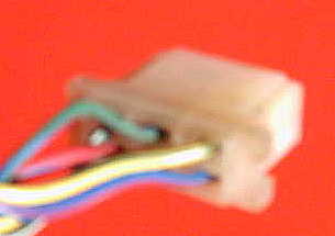

Plug needed is the first picture and the one on the right in the second picture.
Without buying that particular one, I can't be sure. but yes, that looks like the right one. Obewon posted 3 links and the first seemed to have the correct one as well.
#plug8973 is the correct one, I can't copy and paste from there cause it's protected...

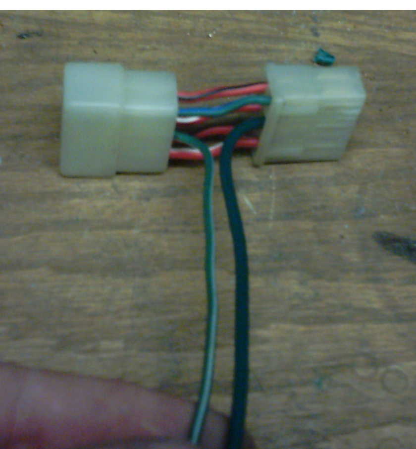

Dave:
After reading this last week I ordered a bunch of connectors and new pins for my projects from vintage connections. Just came in (fantastic service).
Their connectors fit perfectly with our harnesses. See attached pictures of the 6 pin plugs. They should do nicely for your projects. You're back in business!
Seeing those nice white plugs makes all the stock yellowed connectors look very bad. Might have to change them all now, including the pins, certainly the high-current connections at the fuse block, light connections etc anyway.

Well I just got my first of 2 different orders. I ordered the square 9-pin male and female connectors with terminals. I just checked them with my 260Z and they are an exact fit for the combo switch. Which means that not only can I now make Plug & Play Parking light upgrade harness's for the post 3/73 240z's but I believe I can also now make them for the 260Z and 280Z's.
Yeah. No more hard-wire PLH's. All you purist should love that one.
Now that I'm sure of the fitment issues, I'll make a bigger order and post an add with a write-up, informing those in need that they are available.
