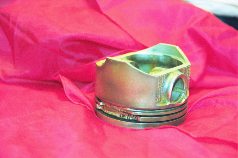

April 16, 200816 yr comment_244257 The trick is, if you want to call it that, with honing, is to move the machine up and down the bore at the right rate to cause the correct crosshatch pattern on the bore surface. Also the grit used is dependant on the type of rings to be fitted. One reference I have [HP Books, "How to Rebuild Your NISSAN/DATSUN OHC Engine" by Tom Monroe] says, "If plain or chrome rings are used, the bore should be finish-honed with a 280-grit stone. A 400-grit stone is good for moly rings. A 30deg. crosshatch is suitable for all ring types." I'm sure it is not hard to do, I just prefer, and advise others, to have a competent Shop do the job, just my input. That piston in my opinion has seen some detonation, I reckon that is what caused the pitting. Or maybe a little coolant leak injecting some water into #6. Unless the ring lands are damaged, I don't see anything wrong with re-using it:ermm: Your choice of course. The attachment shows a piston I removed from a Nissan N14 Pulsar GTiR, son of Godzilla, with an SR20DET engine. The result of uncontrolled boost:finger: Now THAT is detonation damage:dead::dead: Link to comment https://www.classiczcars.com/forums/topic/27731-progress-on-engine/#findComment-244257 Share on other sites More sharing options...
April 16, 200816 yr Author comment_244281 Thanks for the info, NISSANMAN. I took the piston into the local datsun mechanic, and he advised also to just leave it. I got a honing tool, but it has 220 grit stones. Ill have to find finer stones. THAT is damaged, I don't feel so bad now. Link to comment https://www.classiczcars.com/forums/topic/27731-progress-on-engine/#findComment-244281 Share on other sites More sharing options...
