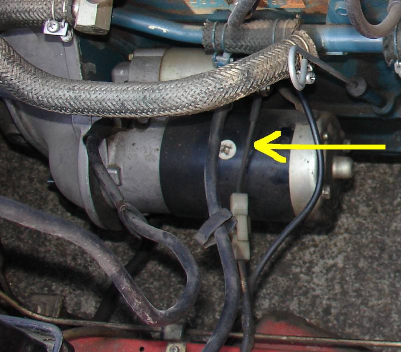

Yeah, there is a fusible link that runs from the big lead on the starter solenoid to the wiring harness. When that one blows, nothing works. See the attached picture.
And to add to that, it may appear to be good on the outside so give it a "Tug" to make sure it did'nt burn on the inside of the wire. Or just use an Ohms meter to check for continuity.
Let us know what you find.
Dave.

The fusible link portion is ONLY from the Starter to the connection at the wire harness. That is, the plastic single spade locking connector connecting the fusible link to the harness, to the Ring connector at the starter.
The rest of the wiring you describe is normal wiring, although 10/12 ga or so.
If you DO have 12v+ at the Regulator (with sheet metal as the ground) then your fusible link IS functional.
That you do NOT have 12v+ at the W/R wire (again to body ground) at the fuse box implies the Alternator's internal wiring.
FWIW
E
