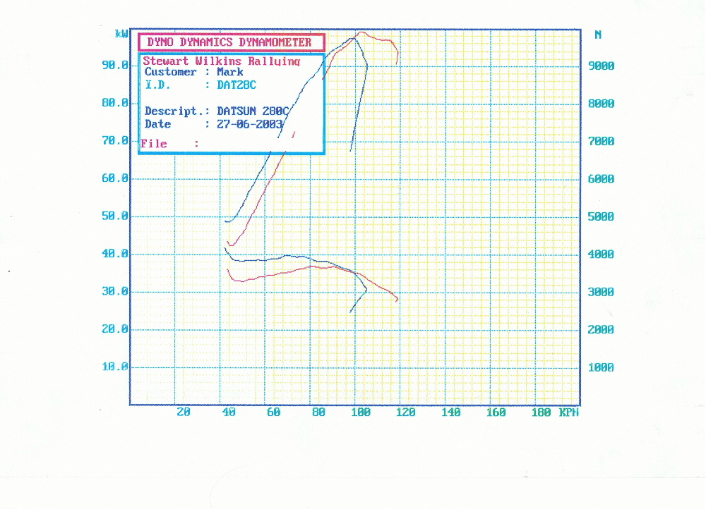

I decided to attach a dyno sheet of a run I made several years ago, comparing the stock cam I had in the engine with a modified, aftermarket grind from Ivan Tighe 462C spec.
No other changes were made other than to instal the camshaft correctly. A/F ratio's were tested and deemed to be acceptable and a solid basis for comparison.
Yes, the rpm ceiling was higher, up to 7200rpm, but what about the rest of the power and torque bands?
I may have been 'put off' by this venture but I have the dyno sheet to prove the worth of 'changing the camshaft'. Would you recommend a bigger cam to someone if you had results that looked like this???

I don't honestly know how to read that dyno printout. It doesn't look like the ones with SAE hp and torque that I'm used to seeing. I'll tell you this though; for my money, I want the peak hp to come about 1000 rpm before the redline of the engine. Getting a camshaft that peaks at 7000 rpm with a 7000 rpm redline doesn't do you very much good, nor does using one that peaks at 5000 rpm. And for my own project I've repeatedly made the error of going too small, while "experts" told me that I was going to regret buying something so big.
