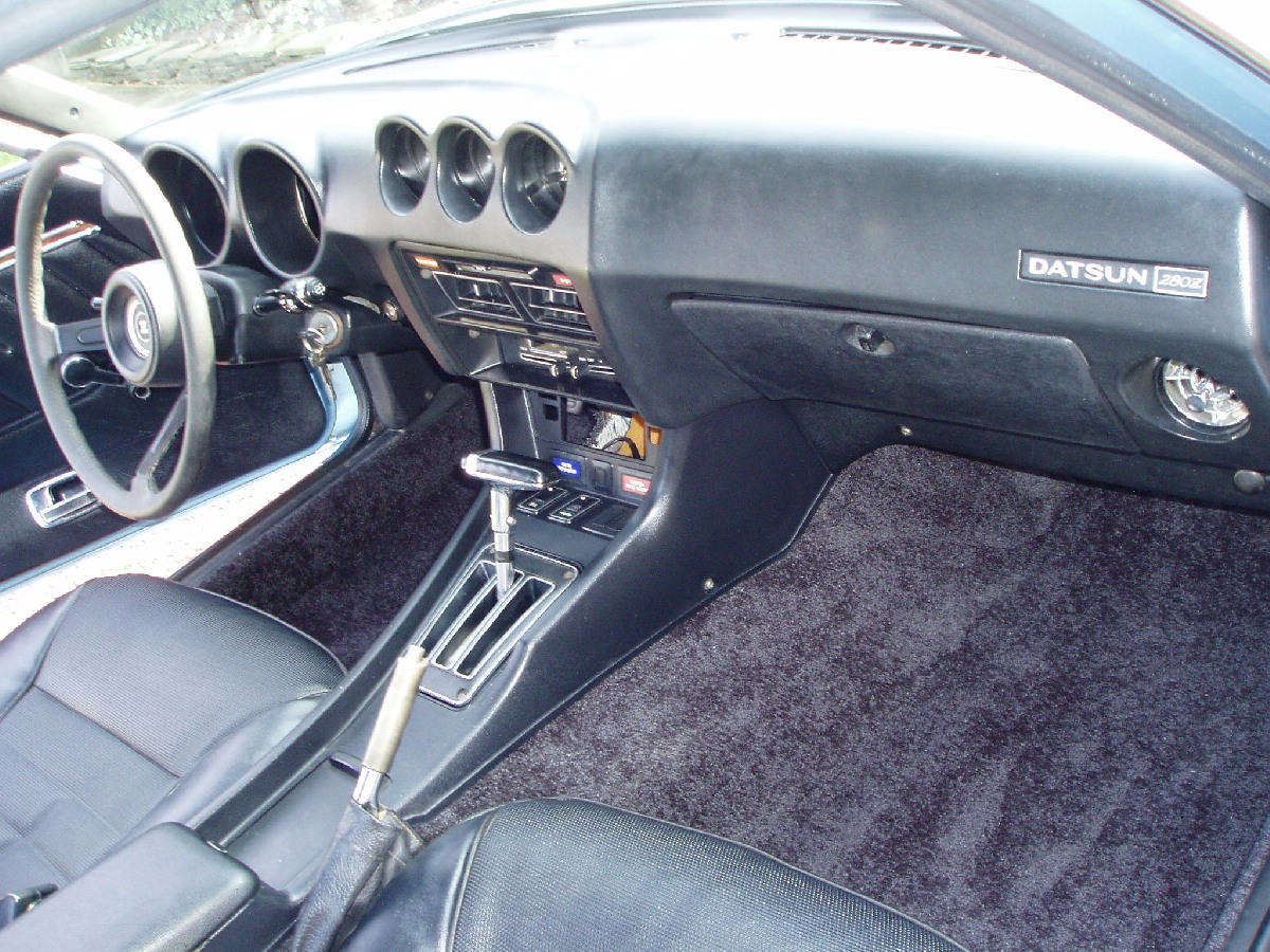

trying to attach a photo of my interior...the 'manage attachments button' isn't opening
I like the interior. Where can you get carpet kits that cover everything? I know of Too Intense. Anywhere else?
Really? Gold and Orange....not to mention the door panels, but hey thats why were all different. Senkyoshi, if you do go with the full carpet look be sure and post some pictures.
7277 your Black looks really nice, I guess it helps out with road noise as well.

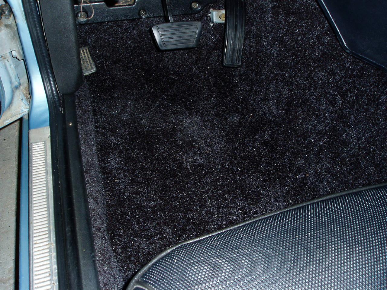

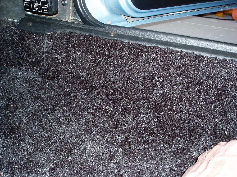

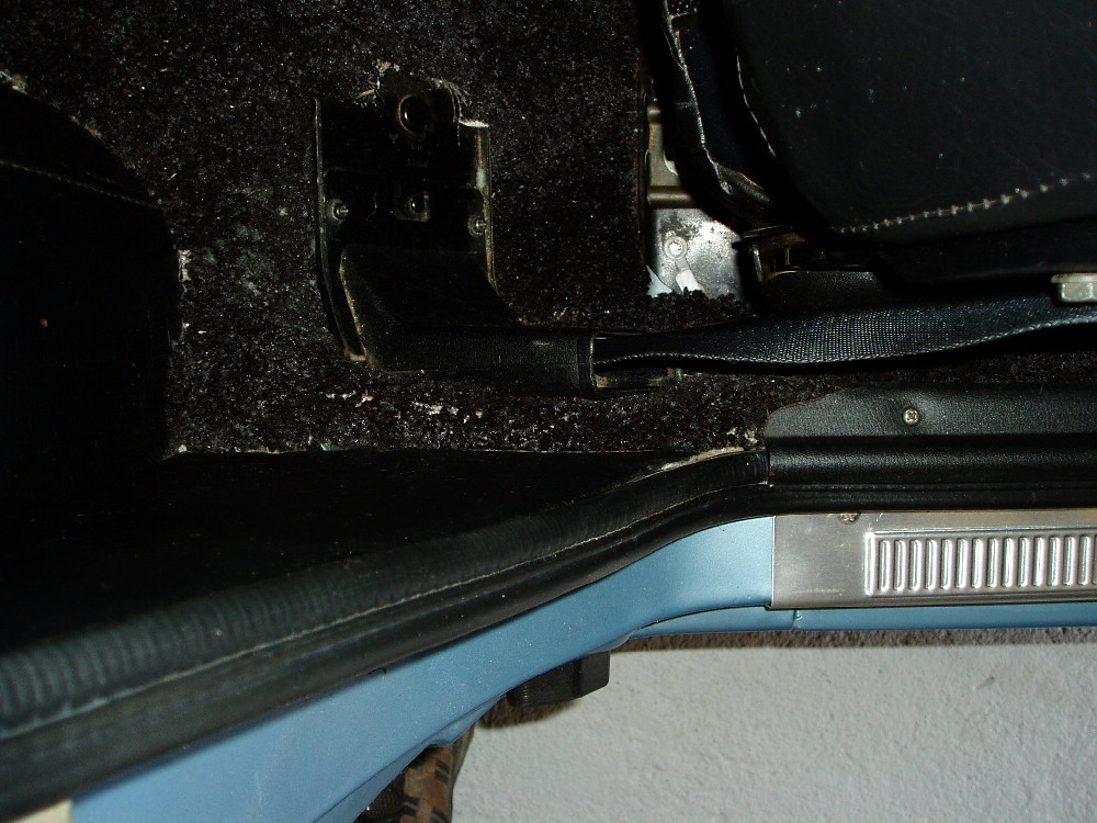

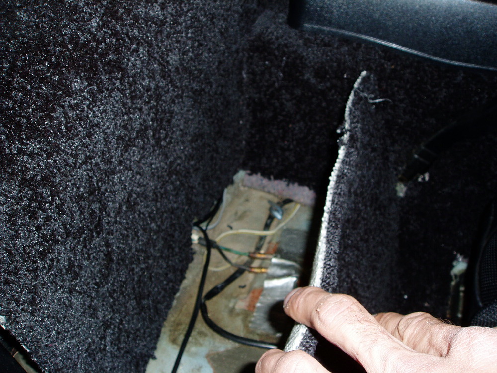

hey senkyoshi: sorry for delay,...been busy.
anywho,..here are some photos of the more difficult parts on the car's floor. basically, you just cut to fit the floor areas, and jamb the vertical pieces into the edges. the seams actually butt very tight where the pile comes out MORE dense, hiding the seam further. the rear deck, under the luggage bar and down the wall behind the seats is ONE piece. the living room carpet bends and holds it's shape...just crunch it and work it a bit for tight areas like the seatbelt area...
i don't know what the gray vertical line is under the fuse cover 'on the carpet'....it's not a seam....must be the camera lense
