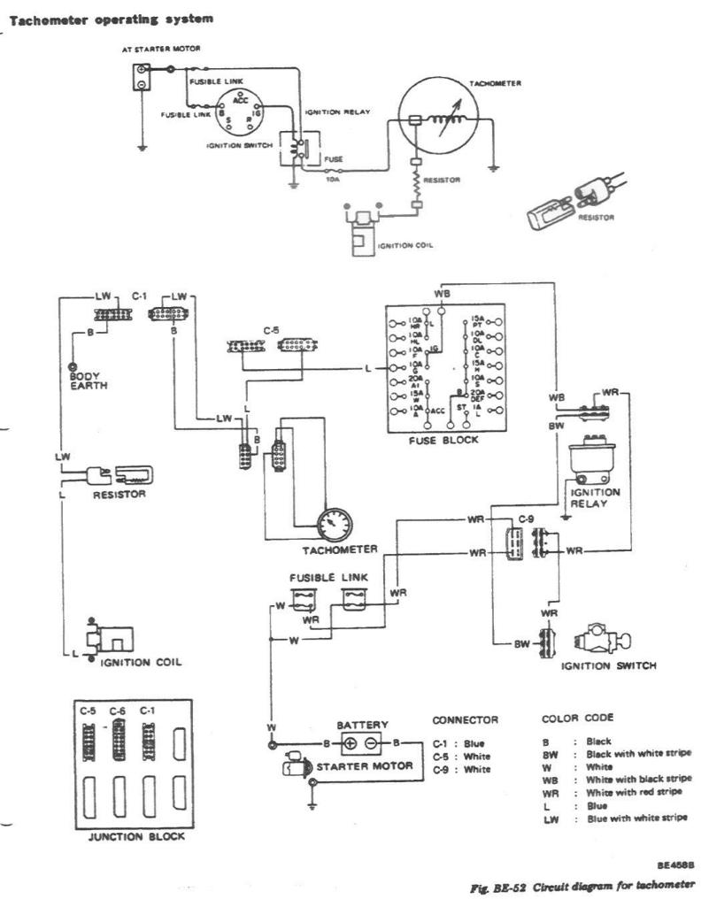

Posted April 28, 200816 yr comment_245574 Hi all, I'm new to Z's but not cars. I have a 78 280Z that some bone head put a 10000 RPM tach in and rigged the wiring around the coil. I put the right tack in and I need to fix the wiring now, but I think some wires are gone. I need a good pic of what should be there, It's a non turbo EFI motor.Any help would be appreciated Robert Link to comment https://www.classiczcars.com/forums/topic/27905-coil-wiring/ Share on other sites More sharing options...
April 28, 200816 yr comment_245576 Does this help? Link to comment https://www.classiczcars.com/forums/topic/27905-coil-wiring/#findComment-245576 Share on other sites More sharing options...
April 29, 200816 yr Author comment_245588 does help some but what I am really looking for is a good pic of the coil area under the hood, there are some cut wires with no plugs. the motor runs but the stock tach is at max all the time. Link to comment https://www.classiczcars.com/forums/topic/27905-coil-wiring/#findComment-245588 Share on other sites More sharing options...
