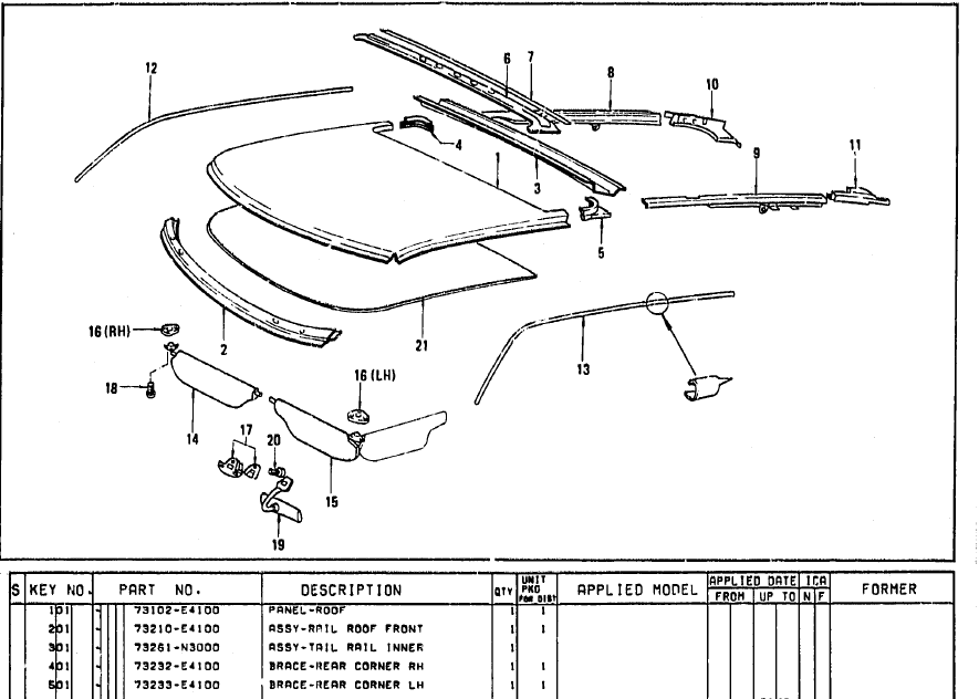

Never thought about a new skin. Part number 73102-E4100, still shows as a good number from Courtesy and NissanParts.cc, albeit at $550 or more. Luckily the donor I had was totally straight.
