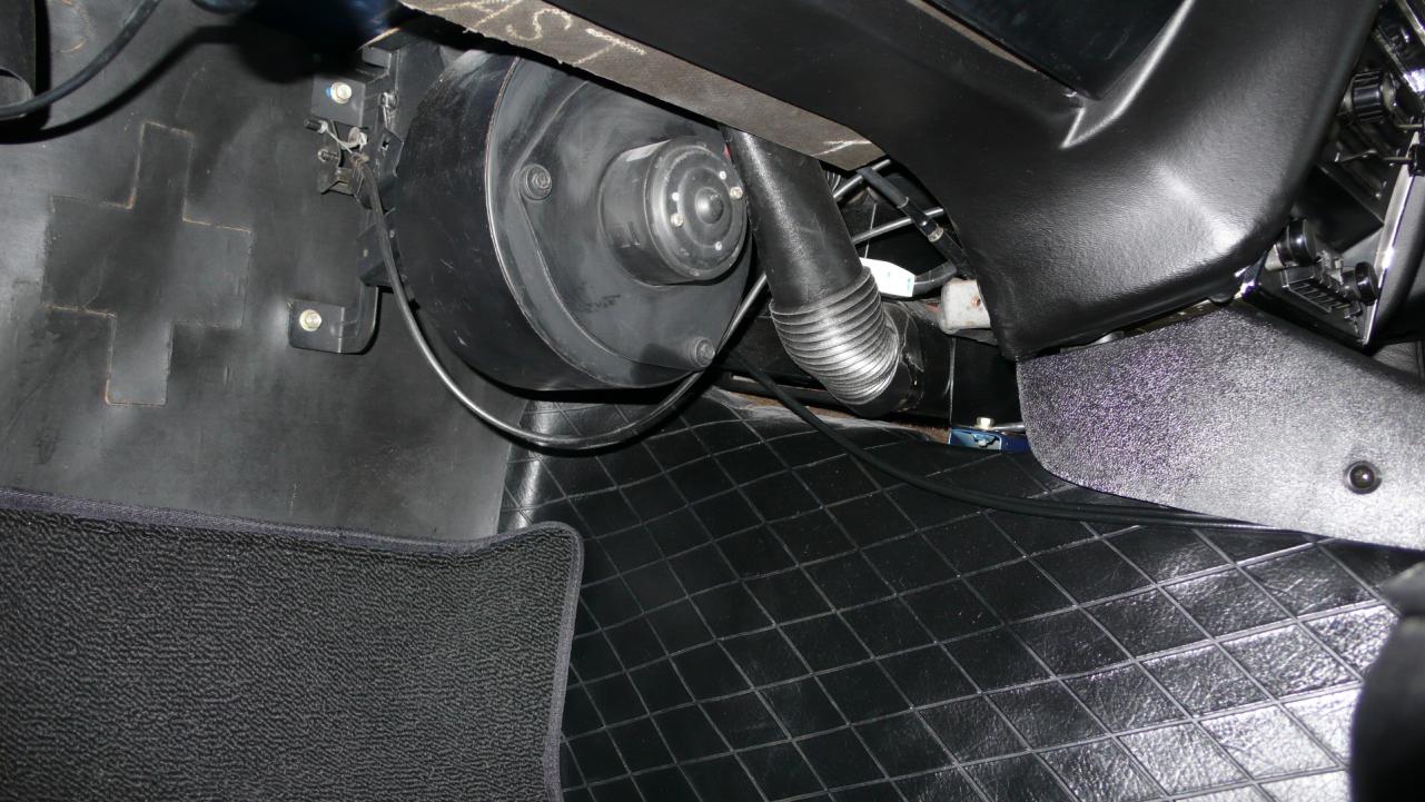

Getting a minimun destruction to interior to house an evaporator. I took the suggestion of the genII mini. As instructed by photos of Derek.
The difficulty is in getting the GenII as the vintage air does not seem to sell overseas, and the other Zshop that sells the whole kit, which might cause less destruction ( the evaporator replaces the heater core in original fan unit??) appears after I got the genII.
I have to ask my relative to get the genII from Canada and ship it to me!
As in photo I hate to say good bye to my original fan

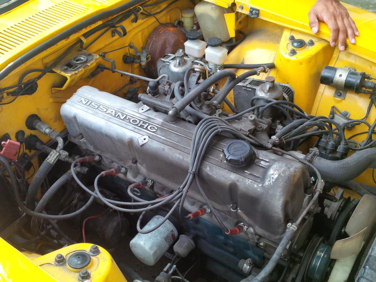

I have a Sanden 508 compressor and have purchased the Gen II Mini kit. Can someone point out which compressor bracket is the one that bolts directly to the drivers sided of my 240z which has an L24 engine block. Have seen many on ebay but want to be sure before purchasing. It needs to be the direct 4 bolt mount.
jalex
Can you give me a link to one or two of the ebay ads you found? I'd be surprised if one them works as a direct mount for our blocks that also puts the pulley in the right position to mate to the damper pulley grooves. If they do exist I'd love to know the source. I've done four Gen II vintage air installs on Z's (ok, one 510) and always just made a bracket to mount it where it has to go. Vintage Air has a set of generic compressor mounting plates to use as a starting point.
http://www.vintageair.com/2014catalog/Pages%20from%202014%20VintageAir%20Cat%20rev%208-15%2069.pdf
part 151015, universal fabricators bracket.
BTW there is nothing premade to make any of this whole process easy. Between making the mounting bracket, adapting the control panel into the console, routing air ducts and adapting them to the dash outlets, wiring, underdash evap/blower mounting, condensor mounting, refrig hose creating/routing/, etc etc etc its all "create it from scratch using your imagination". Installs now take me about 35-50 hours depending on the level of detail fit and finish I'm trying to achieve. It's worth it in the end. It kept my Z cool in Arizona and back for ZCON 2012 and to San Diego and back via Vegas in August while running on low.

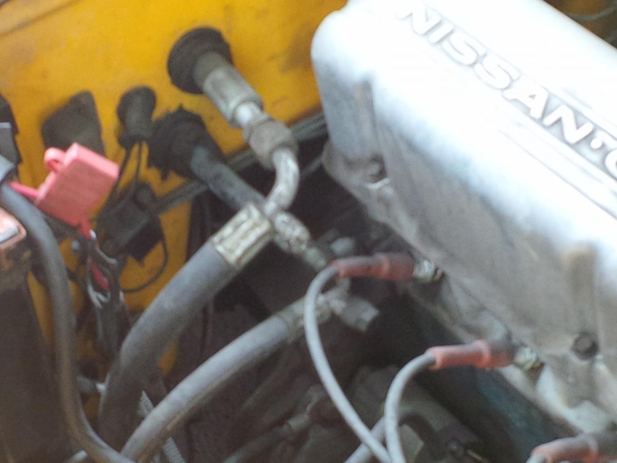

If you are not going to use the heater part of the GenII system then you can just use the heater hose holes to pass the AC hoses. Well, maybe and maybe not.
A great deal depends on the routing of the hoses on the INSIDE and how they have to get from the firewall to the connections on the evaporator box. The stock heater hose holes are right behind the evap unit fan after its mounted, so you would have to run pre-bent hard lines to make an immediate 90 deg down. Each of the various plumbing options that Vintage Air has (rubber hose, hard lines, SS braided and others) will require different routing based on the how tight the hoses can be bent and how you need to get each connection from place to place. Cost also factors in, the SS lines are twice as expensive as the basic rubber stuff for example.
The "correct" way to do this is to mount all the components, THEN route the hoses between them. Unfortunately the stock heater hose holes are not in the best location....
