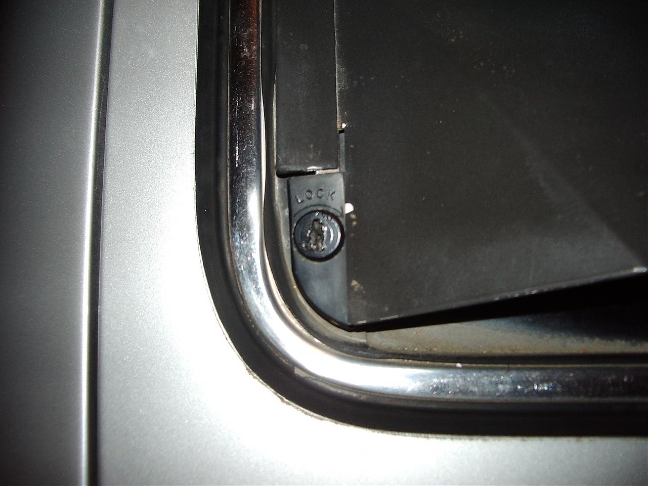

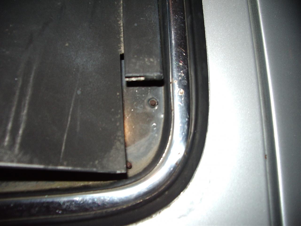

Posted May 6, 200816 yr comment_246483 Well I hve been trying to unlock my rear louvers but cant get it to unlock. Also I have a lock missing. Are the locks sold seperatly??? Here are some pics of my problem... Link to comment https://www.classiczcars.com/forums/topic/28017-rear-louvers/ Share on other sites More sharing options...
May 6, 200816 yr comment_246491 That lock looks like somebody tried to gouge it out with a screwdriver. When you say you can't get it to unlock, what exactly is happening? Is it not turning, or is the cylinder turning but not releasing the lock?Dave M. Link to comment https://www.classiczcars.com/forums/topic/28017-rear-louvers/#findComment-246491 Share on other sites More sharing options...
May 6, 200816 yr comment_246494 You have interpart louvers, the key is shaped exactly like a lower case T a "cross" shape. it is easy to "pic" once you know that(bend a bobby pin into a a T), the other was obvilusly picked with a serious yank upward. that came on the I have not seen the locks sold by themselves-though I have found a source for the latches used on the version of Louvers that came on the Black Pearl.The interpart locks are very simple two aluminum bars wrapped in plastic.Will Link to comment https://www.classiczcars.com/forums/topic/28017-rear-louvers/#findComment-246494 Share on other sites More sharing options...
