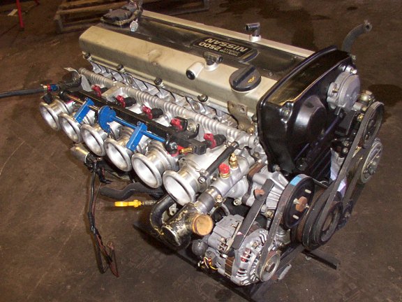

Posted May 10, 200816 yr comment_246822 If anyone is lucky enough to have or know anyone who owns a Z432, I would love to have some detailed pics of the throttle linkage on the firewall where the rod comes through from the pedal to the carbs. I'm installing a RB25DE but with ITB's on the right hand side and not sure how to re do the linkage without going to a cable (last resort). I would appreciate any help! Link to comment https://www.classiczcars.com/forums/topic/28056-z432-throttle-linkage/ Share on other sites More sharing options...

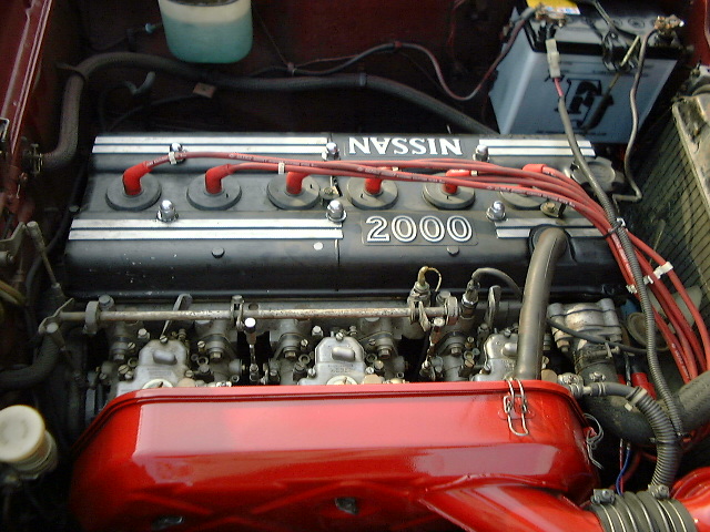

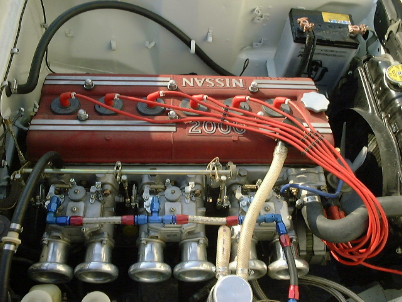

May 10, 200816 yr comment_246825 What, like the first pic? I think this is set up for a cable. I think cable operation would be a better method personally:devious: Or the second and third pics? You can just see the throttle linkage at the far left. Link to comment https://www.classiczcars.com/forums/topic/28056-z432-throttle-linkage/#findComment-246825 Share on other sites More sharing options...

May 10, 200816 yr Author comment_246832 Thanks Nissanman and hls30, that was exactly what I was after! I could understand using a cable; looks like when the engine moves with the mechanical linkage, revs would change too! Found the pic on his website. Hoping the firewall has that thread in there already, don't want to drill any unnecessary holes! Who does that RB25 with the itb's belong to? I'd be interested to hear how it went; what power was achieved.... Thanks for the quick replies! Link to comment https://www.classiczcars.com/forums/topic/28056-z432-throttle-linkage/#findComment-246832 Share on other sites More sharing options...
