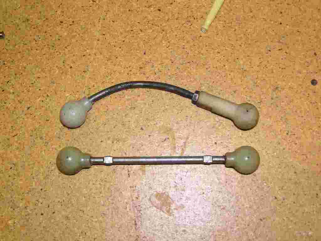

Well, I got another bellcrank and linkage rod and attempted this mod. I sawed off the top bellcrank arm and used some JB Weld to re-attach it in the new position. Unfortunately the arm was a little off when I clamped it so it dried tight a little offset so the top bushing won't fit.
I guess I want to try the "hockey stick" fix as shown in the picture. This seems to be a much easier fix and I hate paying for another bellcrank. I did relube the linkage and it improved very slightly.
I think the rod is from a 280ZX. Not sure if a 280Z would be the right one but if anyone knows for sure please chime in!
I'd like to get my hands on one of these rods so if anyone has one they want to part with please pm me. Thanks!

That is a good suggestion but I would have to thread the piece I attached so that I could screw the plastic connector back on. I also don't want to adapt my rod and have no backup so I would want to get another rod anyway.
Unless I can explain it to a parts place or find someone who has one here I may be doing just what you say. I don't know the ZX's at all but I looked at a picture of a 280ZX motor and I saw the rod connected to the linkage towards the front of the motor.
Getting the other rod is a good back up.
What I meant about using the pipe, is that you would cut the rod and insert the piece of tubing to lengthen the rod and would insert both halves of the original rod in to either end of the tube. The original threaded ends would still be there for the plastic ball connectors.
