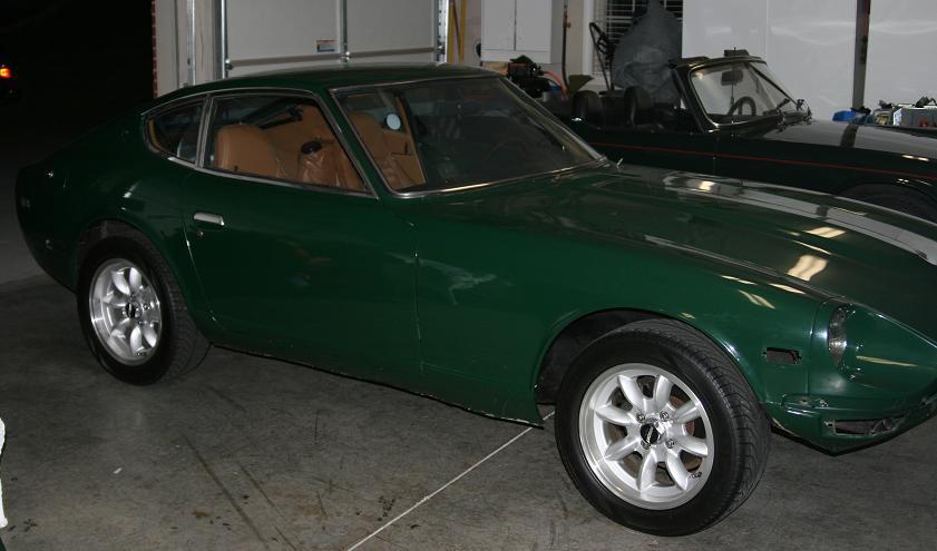

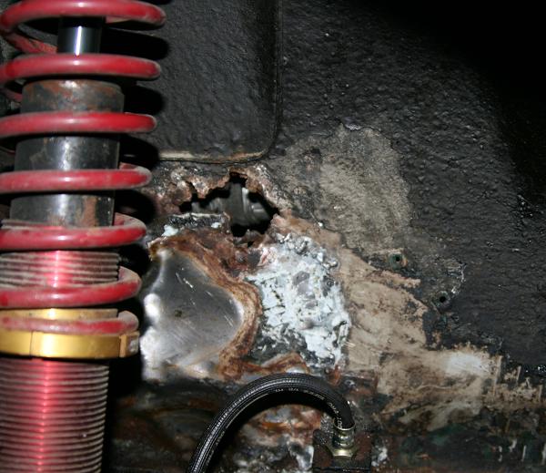

I went down and checked out the shop and the personel and was very impressed, so I decided to let them take a crack at my 71 240Z. They will sand the entire car, fix the valence and rust hole, and fix any other dings or spots on the car. It will also get a base and clear coat of the original color.
I did all the removal of the exterior...(ok, I still have the door handles) and will drop the car off on Wednesday (May 21st). They stated the car will be ready in about two weeks. I really think they will do a good job, and If so may get the TR6 painted as well. My car really isn't in that bad of shape for paint, but since I'm getting the repaires I thought it would be a good chance to give them a shot.

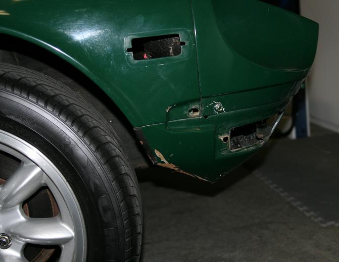

I'll let you know how it turns out. Here's a few before pictures.

Lastly, that right front under valance. This is a typical problem with the Z. Especially after changing to wider tires than the cars were fitted with originally. The problem is that the tire grabs that valance and literally tries to rip it off the car. This is most noticeable when backing up and turning the wheel, or when going up and over a bump such as appears at the end of many driveways and the curb. The only solution I've found for it is to bend the valance a bit further out to increase the space between it and the tire. Interestingly, the driver's side isn't as prone to this. Ask the shop to look at this specifically.

I have discussed at lenght with the owner and manager all our expectations....both mine and his. Of course it's not going to be a trailer queen show car, but a really nice quality base and clear. The car will be sanded completly and nothing but metal if needed will go back in. There really is just that one bad spot under the wheel well.

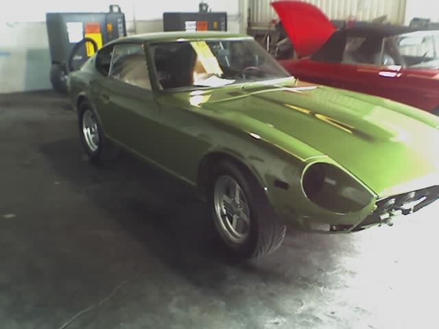

I took my '73 to the local Maaco (San Jose - Stockton Ave) and they did a great job for me. They ended up taking the whole car down to bare metal and repainted it in the original 113 green. I'll attach some pics. The total when all was said-and-done was $1400. They painted the cowl off the car so they could get good coverage by the windshield. I had removed all the trim, emblems, bumpers etc and cut the weatherstrip away from the glass so they could paint in there.
If you really want a nice paint job, then remove the front windshield and the rear window from the hatch. It will only cost you a little extra, but the difference will be extraordinary.
