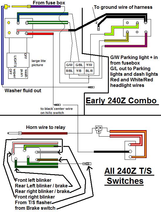

Zs-ondabrain: What is really needed are schematics of the Turn Signal Left hand stalk and the Right Hand Stalk combination of switches for those completely rewiring a 240Z. With your knowledge and ability to rebuild these switch assemblies it should not be too difficult to come up with schematics of same. Would like to hear feedback from you regarding this matter. Please advise. Thanks.

do you buy chance have any pics of a 260z headlight switch and connector? ive had the car for a few years and its time to start fixing it up. the problem im having is the P.O. or someone before him cut the plugs off both switches, i got the turn switch figured out since the wires all matched in color, but none of the three headlight switches i have match the car side wires, well, most, the dash lights is about it. i have a FSM but it seems all my switches are for a different car. my build date is 7/74. thanks

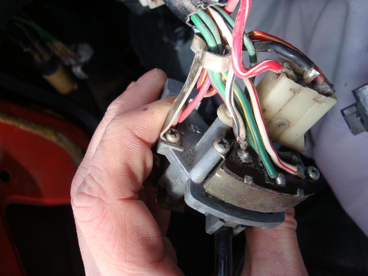

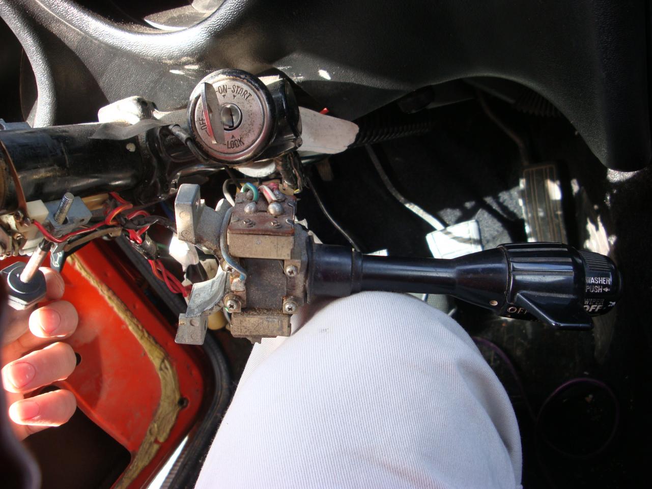

Here's another ....
2/73 240Z
3 position wiper and usual everything else, long pigtail on Turn signal switch.
Also, I believe the combo switch sits on an upper angle (due to the 3 position wiper switch) as compared to the earlier 240Z switches that sit in the center of the metal chassis.
My car is a 2/73 so unless you want pics from me I'll stay out of this.
