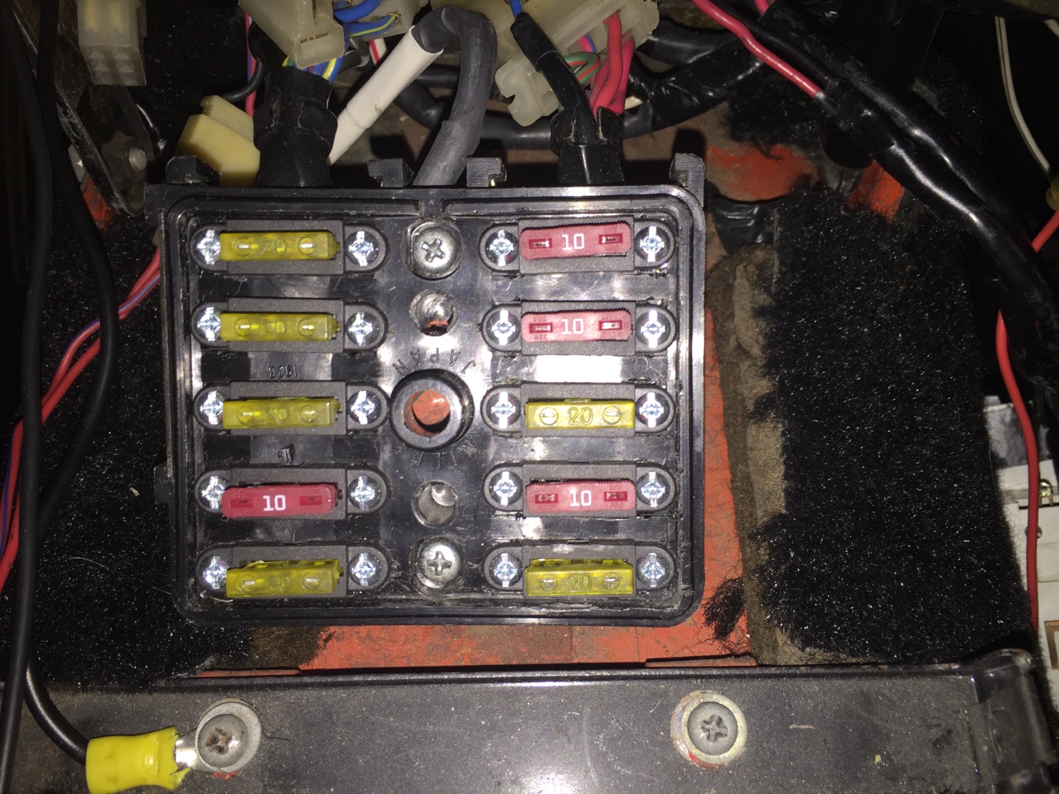

Just to let you know, it is not that hard to take your existing fuse box and convert it yourself. I did mine for about $15 in parts.
Phil Smith
Phil, you can't just leave us hanging! Tell us how you did it, please. I would love to be able to do that changeover with modern fuses. Pics, please.
Cheers, Mike

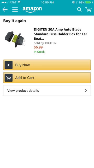

Amazon, Amazon, Amazon - bought the fuse holders from Amazon. You need 10 and they have 10. $6.99. I think 1/2 inch long screws that fit through the holes in the fuse holder, washer and nut on the back side. Take photos of the wiring before removing it from the current holders. I popped out all of the holders while still attached to the wires. I took a Dremel wheel to cut through the plastic just wide enough to fit the fuse holders in place. The screw holes should line up with the holes that were left from the original fuse holders. Once all 10 are in place, then you can start soldering wire for wire to the terminals on the new fuse holder. The battery wire is the hardest to do because it has to connect to 3 of the fuse holders. Easiest way is to strip the wire long enough and tin it with solder before soldering to the 3 fuses. When you install the blade fuses you will still be able to use your fuse box cover. If you have serious melting of your current fuse holder, you will need fix that problem as well. Picture of the front side only and the fuse holders from Amazon.IMG_9403.JPGIMG_9405.JPG

Three posts and full of useful information. Welcome to the site. Thanks for the link. I've searched Amazon for fuse holders many times and don't recall seeing these puppies.
