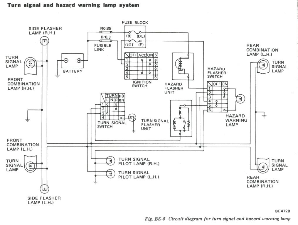

The attached pic. is a diagram from the 810 Nissan FSM and shows the principal of turn signal and hazard flasher operation.
It is intended as a guide on what to look for and where to look when trouble shooting this system.
Note that the Hazard switch, when OFF, needs to connect two wires together for normal turn signal operation.
Unfortunately, the wiring diagrams in a lot of aftermarket Manuals are absolute crap.
That is why I prefer the Nissan FSMs, they tend to break things down into nice little schematics like this one:classic:
