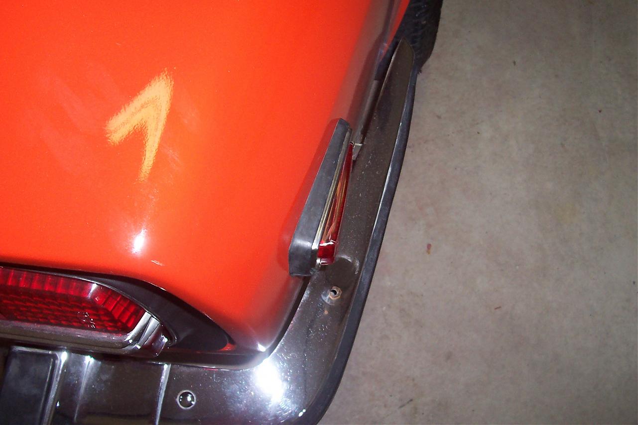

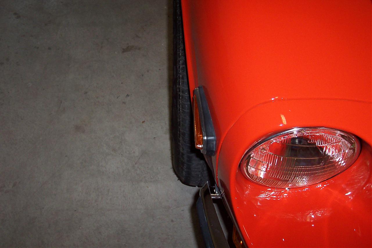

Your goal is to make them as 'flat' to the surface as possible (if you were to imagine your Z-car as a box with 90 degree corners and flat sides). This way, the reflections (and transmissions) of light will be optimal in a driving circumstance. Soooo.... the fat end on the amber front ones goes forward, and on the red rear it goes aft. I hope that makes sense (it does to me, but you don't know 'me'). If not, let me know.
I have mine installed with the fat end of the gasket facing forward in the front, and backward in the rear. That way, looking down on them, they are both parallel to the cars lines.
Actually the car's body lines curve... and that is one reason many people install the side markers wrong. I think it would be better to say that the lens of the side markers has to be parallel to the car's centerline.
just a thought..
