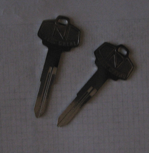

Jon,
Those are two sided keys. Unless your locks have been replaced you should have a one sided key for a 1970 (doors, hatch, and glove box) and a seperate one sided key for the ignition. There are two types of two sided keys, one with a groove on the left side and one with a groove on the right. A car could have either the right groove or left groove type depending on what locks it had.
-Mike
I believe there are three keys which are used in our Z's. (four actually) Earlier cars had the one sided key. Then there were two series of double sided keys.(DA24&26?) If you get an aftermarket ignition switch then it is for an even later style Nissan switch. (1982+ I think)
I recently went to my dealer and tried getting duplicates for my newly purchased IGN switch. They tried the two double sided styles which came with 70-78Z's. The keys didn't match so the locksmith figured it out in minutes. I think the keys went in an '80's Maxima or ZX???
Moral of the story is to visit the locksmith. :)
2c
Jim
Alright. I learned from an earlier post a few months ago that my car should have one sided keys. Unfortunately, at some point my locks were replaced. I now have one key for my ignition and doors, and a separate key for my hatch. They are this style of key, but the grooves are on the wrong side.

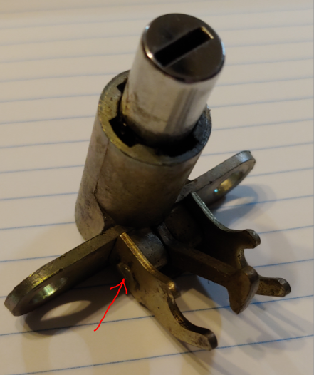

Totally different design on the 240, here's one from my parts 1970 car. I wonder if you could grind off the peened over end of the pin, so that it and the latching lever could be removed, to let the lock cylinder slide out? To re-assemble hopefully a center punch or two to the edge of the pin would be enough to retain it. Or change to a spring pin.

@CanTechZ yeah I was thinking that’s really the only spot you can get started with, if I come across a spare I’d love to try it out and document it.
the ignition was not to bad, you have to remove the pin that’s jammed into the body and the tumbler housing, 3 small drill spots and can push it out.
@Captain Obvious IMO another reason I kinda like the later series cars more….. and the HVAC panel…. I repinned it on my 260z I thought it would be easy on the 240z as well.
I have no key for the lock, so no big deal to take it apart. The mistake I made was trying to remove only the peened part of the pin with a chisel and then driving it out. Due to burrs it got stuck part way through and bent slightly. One thing to watch out for when driving the pin out is that the mounting flanges bend quite easily. I held it in my vice by one flange and blocked the side for support, while driving the pin out.
